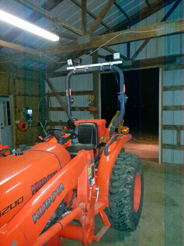

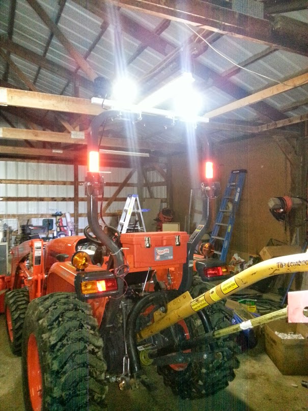

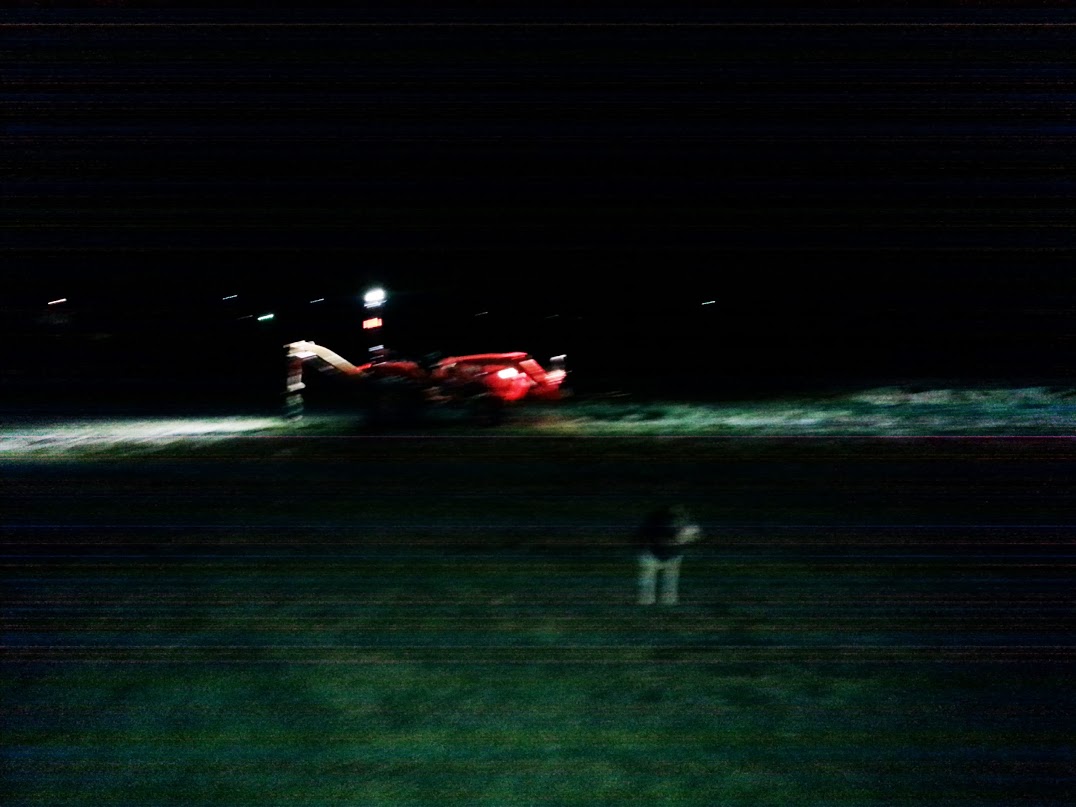

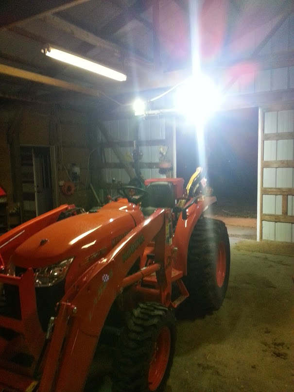

I put my LEDs up on the ROPS bar, 2 forward & 2 back. much better coverage instead of the headlights bouncing off the back of the bucket blinding me & not lighting up where I'm going.
Yep, after adding LEDs to the ROPS I have already forgotten I have halogens in front that are blocked by the FEL. Never turn them on.
   / Halogen to LED conversion #12
$100 worth of Tuff-LEDs off Amazon (cheaper now it looks). I used U bolts to put some random piece of square tube ontop of the ROPS with PVC pipe cookies as spacers. A little extra effort, but I figure it's worth it on the off chance of causing problems when I really need the ROPS.
IMG_20131017_211735.jpg IMG_20140209_110007.jpg IMG_20131017_211824.jpg IMG_20131017_211833.jpg
Without
With (crappy shot with flash, but still shows the effectiveness)

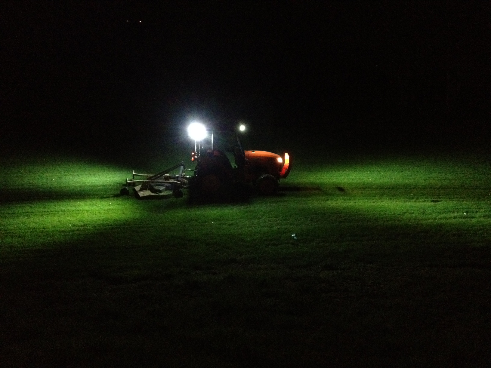

LED's in the front yard. Lots of light without lots of current.
