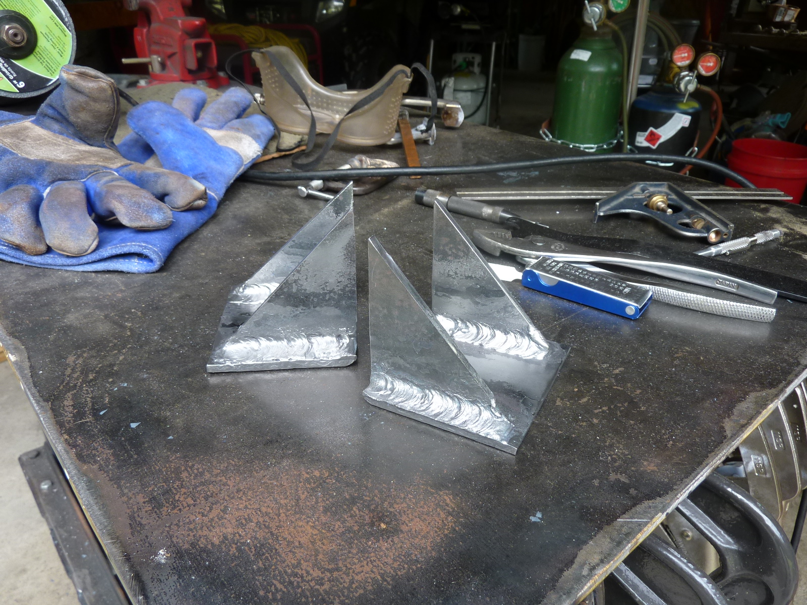

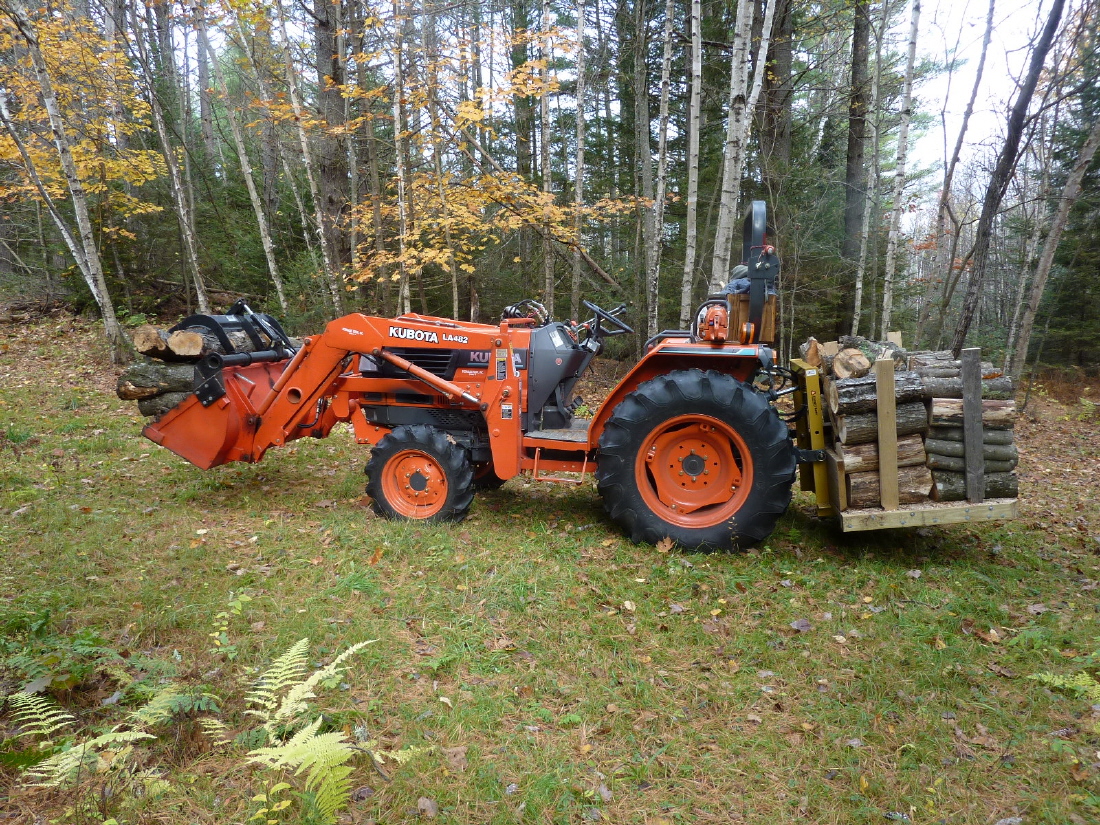

I guess I went over one to many bumps carrying 1/3 cord loads like this and bent the angle at a lift pin.
For a $119 carry all frame the you can't beat the TSC unit. It will take the weight on smooth going but bumps are a killer. We had a rainy day last week so I straightened the angle and made a couple gusset plates (??).

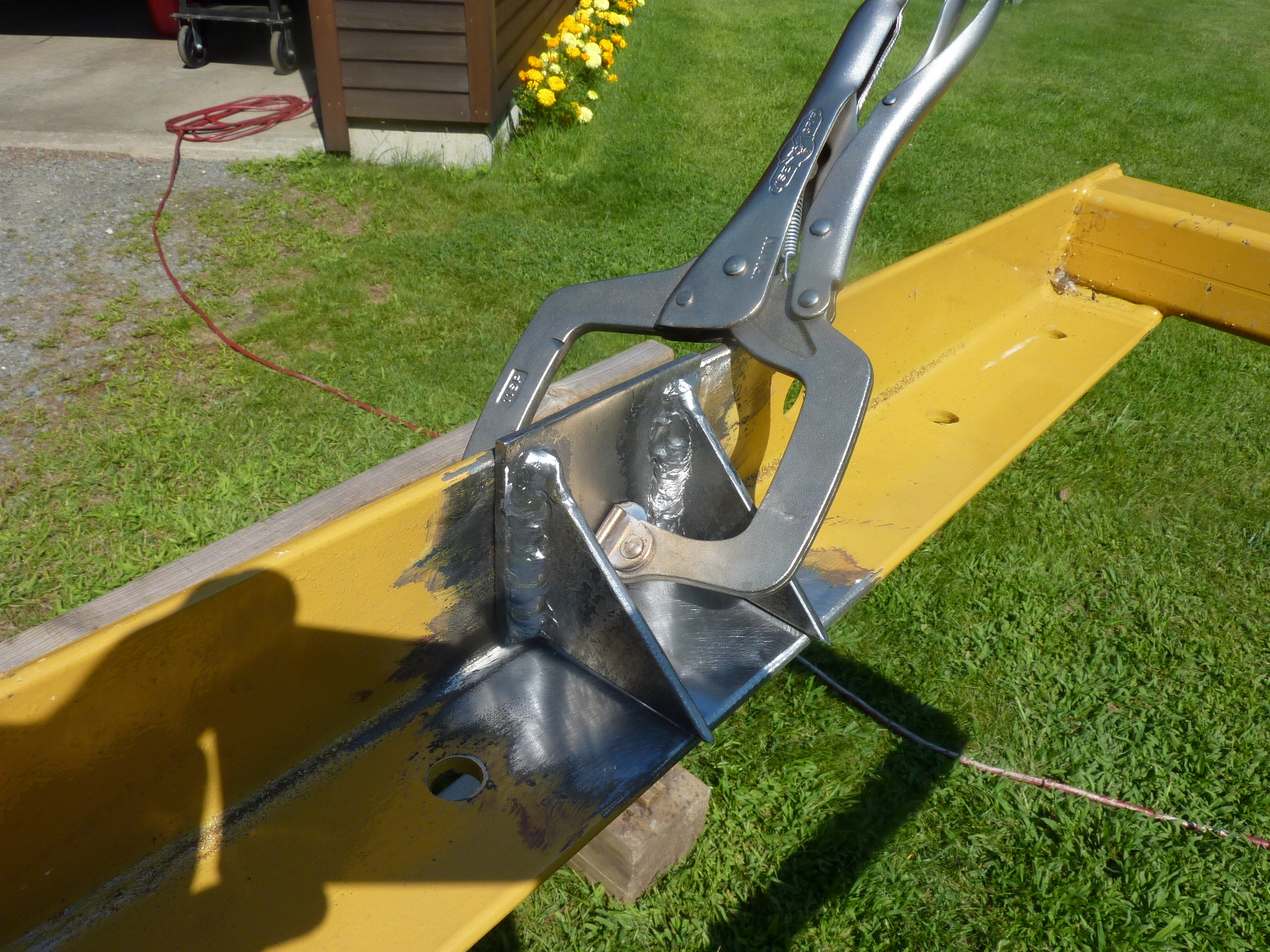

Yesterday I welded them on the CarryAll.

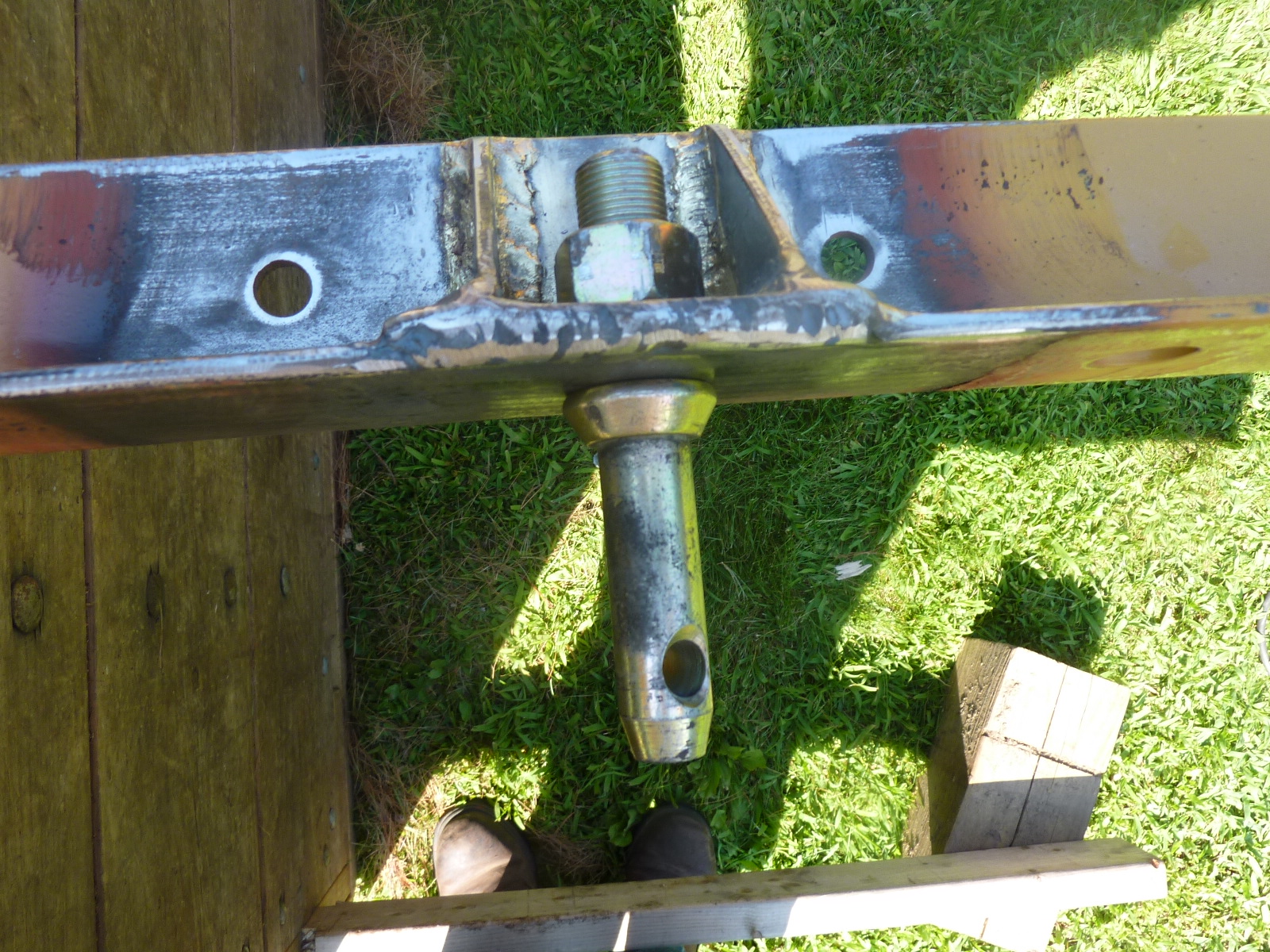

I think I made the lift pins a lot stronger so I wonder where the weak point is now :)
gg

I think the weak point is that the lift pins are on angle iron. Square or rectangular tube would be a lot stronger.
Not saying you didn't do a good job, just answering your question as to where the weak point is.

Maybe you are right - but is it really still like angle with those gussets ??

Nice job! To answer your weak point question, it will be where the welds meet the angle, AKA stress risers. Just keep an eye on them for cracking.

You definitely improved it and strengthened it with the gussets. But I think the whole angle iron upright is the next weak point that will twist. It may be perfectly adequate as you have fixed it but you asked for the next weak point and that's where I think it is. Note, heavier duty equipment usually uses a through pin between two supports instead of an unsupported lift pin.
No matter how much you beef something up, there will always be a "next weak point" :)
