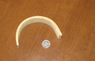

OH, but it steam bends so good.
But I'll never cut it with my band saw again. Bout never got all the sticky juice residue off the blade and tires.

No, I'm not a furniture maker although I've made some pieces over the years like a gun cabinet, small tables, and head boards etc.
That pictured was a test piece (first attempt at bending) from a tree in a fence line that needed to be removed. I do have two forms built to bend old high chair arms for a restore as soon as I cut down the elm tree. I'd rather have white oak but I don't have that available.
