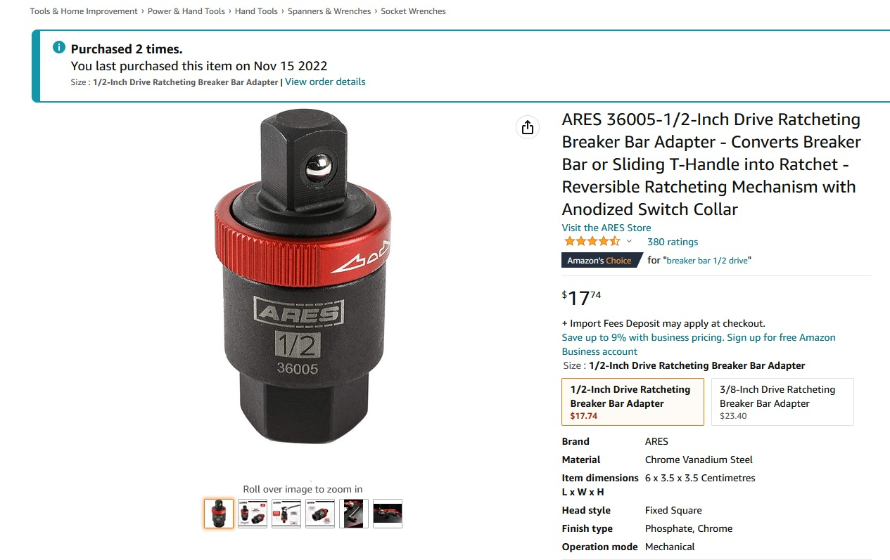

I start my similar sized generator engine running on propane with a cordless drill.
I was making up a bendix drive system with socket of the correct size (23mm) welded to it but my next try will be with a power bar rachet to act as the bendix drive.
You need a drill with some guts.
I have made these systems for two of my brothers and both love them.
I buy a cheap recoil starter on line, remove the guts and drill a large enough hole for the socket to fit thru. This to keep rotating parts separated from fingers.

Very interesting idea. I don't have a powerful cordless drill and would need to buy one of them. I personally like the idea of just turning the key and letting it fire up.
