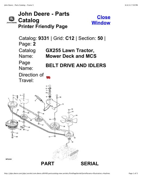

Thanks again .... but you are describing the mower (or cutting) belt assembly.
The 'drive' belt that I need help with is the "transmission" main driving belt that travels underneath the seat assembly from rear fuel tank area to the front steering area.
/ GX 255 drive belt #9
What you are describing is referred to as the traction belt. I don't see a procedure in the online operators manual, but is referred to in the troubleshooting section.
There is that spring keeping tension on the idler pulley shown in your drawing. Disconnect that spring and the belt should slip off over the clutch and the fan.
Something get caught up in there to tear up that belt?

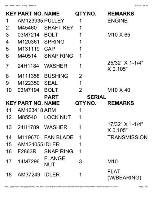

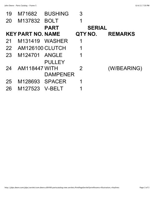

Sorry everyone for the confusion, but ...
The JD diagram and parts list I posted is correct as "BELT DRIVE & IDLERS".
The right frame is rear and shows the trans. fan and the left side shows the front pulley and underneath that is the clutch.
At my JD store, they call it a "Drive belt" as listed in the caption of the drawing and as part #26 it is a generic "V-belt". It costs about $45 or twice what a mower belt does.
You can drive the tractor without the mower deck and belts but you can't drive the tractor without this 'drive belt'.
So, I ask does anyone have experience with this and as to the best way to replace this belt since it is 'tight quarters' and more involved than the deck mower belts.
Someone suggested removing the seat and chassis from the frame and attack this from the top vs. working from underneath the tractor. Thanks again!

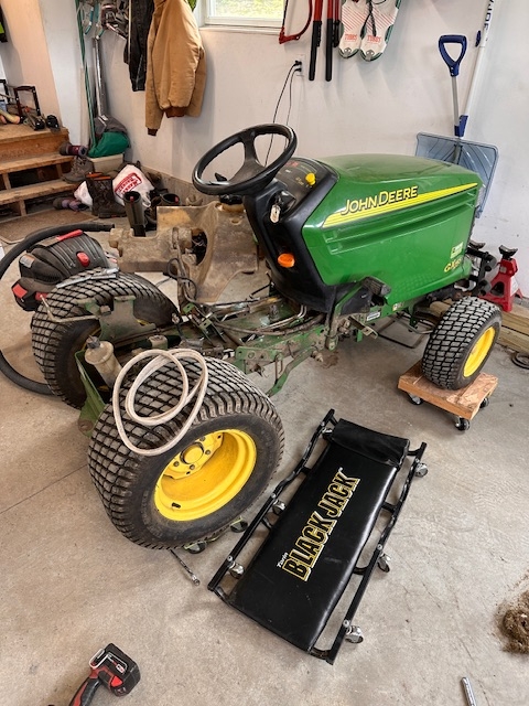

I bought a Gx255 last year for my son (14) to begin mowing in the neighborhood. It’s been a solid rig, but the drivetrain belt just went.
We towed it home with my 4052R and looked to see what may have been causing the issue. As I was looking under it I yanked out a 1/2 stick that was jammed up in there - likely helped with its demise.
I’ve watched some sketchy YouTube’s on this job, but I can’t find one that makes me think this job will be simple. Tip it up vertically - take off the operator station - crawl around under it - all sounds dreamy. I flirted with having the dealer do it, but I’m not looking to toss money in the fireplace.
Headed down to buy the belt now, but nothing is in the manual for this job.

Thanks for the reply! Agree this will be a learning experience!
When I say operator station I’m referring to the fender deck.
I found a YouTube where a guy takes that off - but I also found one where a different DIY guy hangs the tractor by the front so he worked on it vertically. Front end was tied to a beam with the fuel sealed off with a trash bag and the battery was flipped to keep it from leaking.
I’d personally like to work on it from the top and avoid the circus, as you suggested.
Just got the belt for 50 bucks - which will be the easiest part of the job. 🤓
So far, I think my steps will be to remove the mower deck, then remove the fender deck. I’ll check the pulleys for wear when it’s all taken apart.
This old thread was about the best resource out there.

I tackled the job today. It’s not bad and nobody should be afraid to tackle it. I didn’t have any directions other than what was discussed here. I just took my time and kept the workspace organized. 😎
