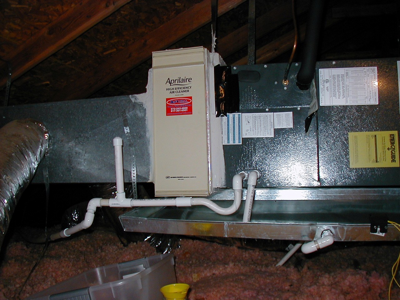

Bird, could you put some plastic wrap over the sink drain and see if you have a positive or negative pressure? Might help in the diagnosis.
   / Gurgling Sink Drain? #23
In post 15+16 is the answer to your problem.
In the cooling mode there is sufficient condensate to keep water in the trap on the A/C unit, when you change over to heat mode there is no longer any condensate and the water in the trap eventually evaporates allowing the air to move freely down the drain pipe to cause the gurgling.
To check this you can plug the drain TEMPORALY with a stopper or rag or pour enough water in the drain to fill the trap.
Plastic wrap over the drains in both sinks are definitely pushed (or sucked) down into the drain when the heat comes on.

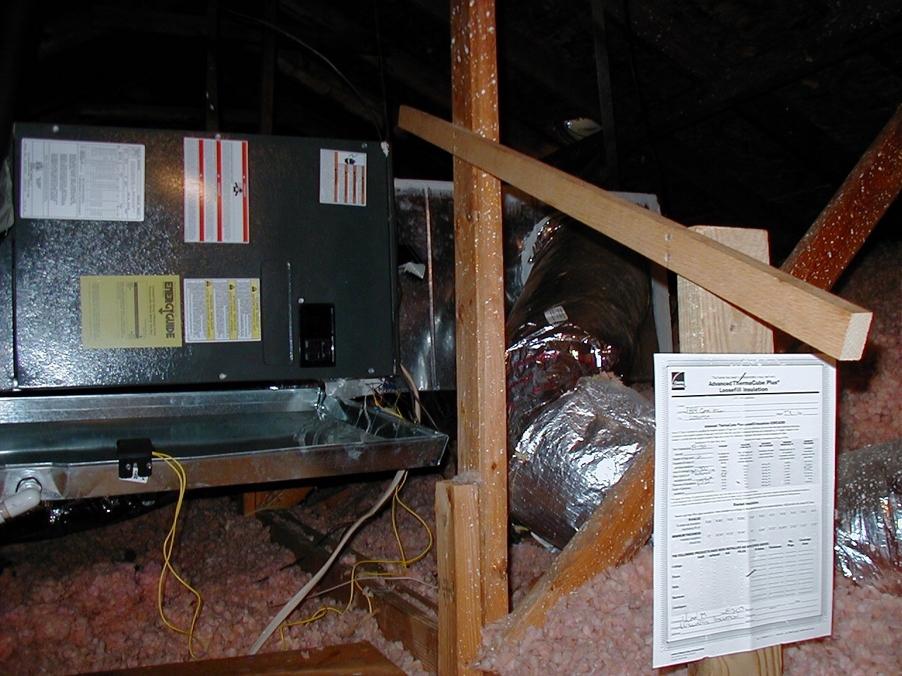

Ken, once again it appears that you (and SandburRanch) may have hit on the right thing. I poured about a cup and a half of water in that HVAC condensation drain and no more gurgle in the sink, at least for the first cycle. With our old HVAC system, that little P trap was downstream from the "standpipe?" in which I periodically put a little bleach, but with this new system, they put the P trap upstream and I hadn't really noticed it. But if you pour enough water in fast enough, it'll get back to the P trap.

   / Gurgling Sink Drain? #27
Yikes.....looking at the piping pic, sighting across the bottom of the drain pipe to the top of the trap appears to be awfully close to the same level. Not much of a trap.....is it?
