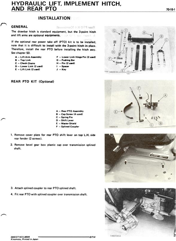

I have a Yanmar GT14. I am looking for a 3 Point hitch for my tractor that can use the hydraulic lift of my mower deck. I have a friend that can fabricate one if I can find a picture or schematic of one. So far I have been unsuccessful. Does anyone have a pic or schematic?

I have a GT14 as well, and I've heard the 3pt is no longer available, but you might check with Len or Gary and see if they can still get one. I would just fab one if you can't find one. Gary has blowups of the parts I'm sure, or I could send you a pdf if you don't have one. The stuff is all shown in the shop manual.

Sorry. You can wait a few more weeks until I get a new job, or you can order the Parts manual for the GT14. I think it's in there. There's also a good amount of photos of the setup in the service manual, but I'm not sure if there's a blowup picture of every part.
   / gt14 3 point hitch #6
Ok, I have photos for you, here's no 1

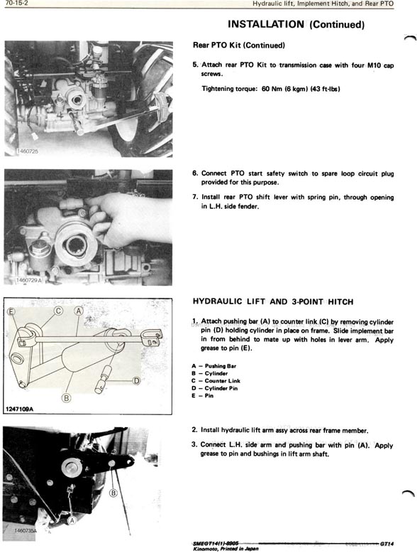

no 2

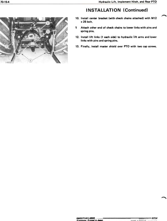

no 3

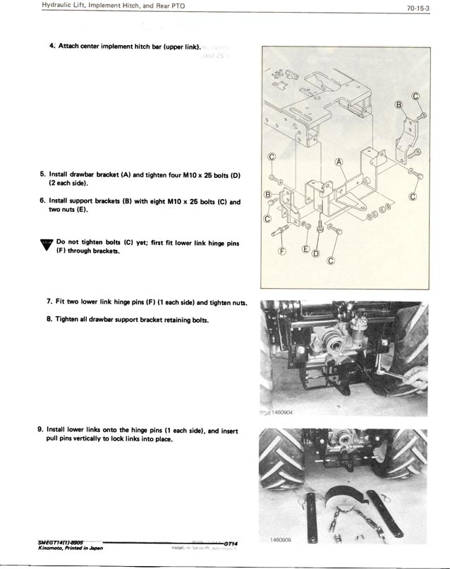

no 4 - final.

Thank You for pictures they are very helpful. If I could ask another question. What is the length of part (G) Pushing Bar and what is the length of the (D) Lower Links.
