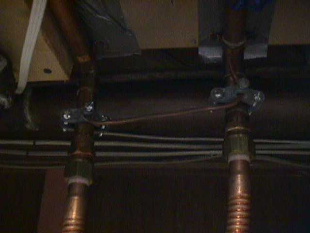

Jumper around the hot water heater

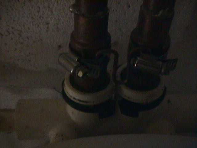

   / Grounding wire question #9
manufacturers jumper that was supplied with the water softener. It is too small to meet the requirements of the National Electrical Code, so it was supplemented with one the correct size.
