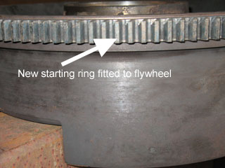

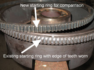

You should look at the teeth on the flywheel not just for a broken one but they also should be tapered in a way that will allow the two gears to engage each other. This is a small picture but it's the best I could find showing a good and bad flywheel ring gears. If you look closely at the second picture you can see the tapered tooth profile of a new ring gear.
