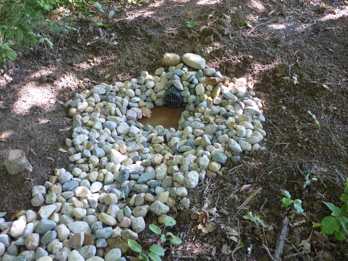

/ Grey water drain #23
First I would prefer greywater to plants that I will not consume. I'm a big fan of drywells. Instead of spending money on a tank, I would just dig a drywell filled with large stones near the flower bed and pipe the grey water to that. I would also run a trench of knuckle size stones along the garden as a over flow connected to drywell. Water will migrate out and if the flower bed is on downhill slope side of drywell, water can saturate underground keeping soil most for garden and its filtered by dirt. Less worry about cleaning up the lint mess and dirt can clean up the water somewhat.

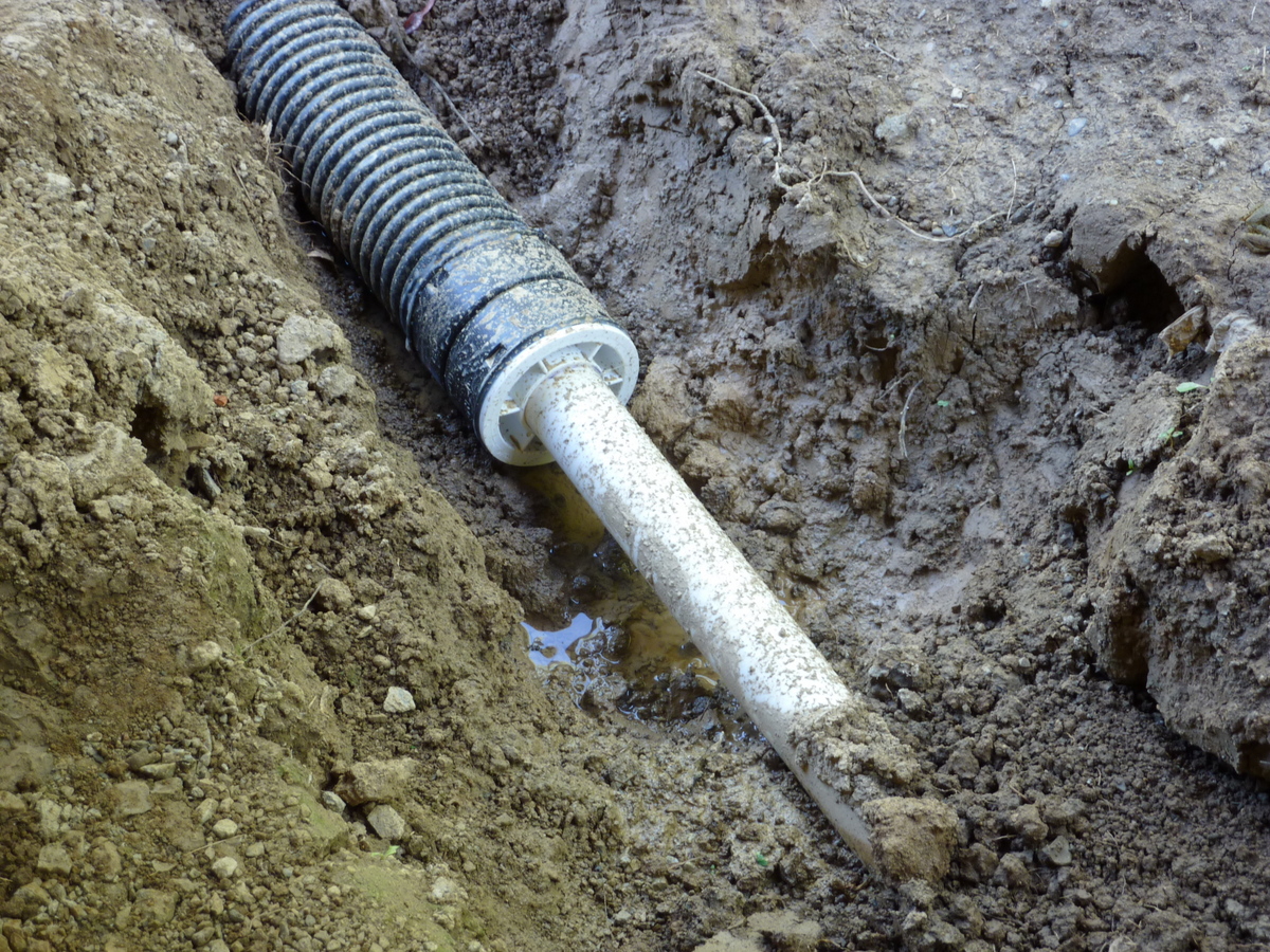

/ Grey water drain #24
My set up... 2.5 inch PVC transitions to 4 inch corrugated / solid
