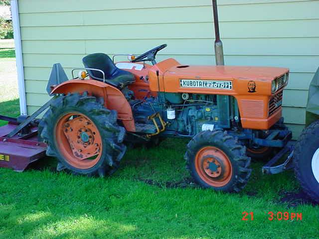

I have a Grey Market L2201DT Kubota. It has a standard PTO that turns the correct direction. I order parts for an L245DT (american counterpart) when I need parts and maintenence items. Only difference I have found so far is the PTO , the Grey has 4 speeds. I assume there are a few gears that are different inside. I did have to split the tractor to replace a bent PTO shaft but located a used shaft quite easily. 25 years old and running strong!! Naturaly there are no ROPS or PTO shield .There is a ROPS program availlable from Kubota for the older tractors. I could order Rops for an L245DT that would fit perfect , but it would not fit under my garage door !
