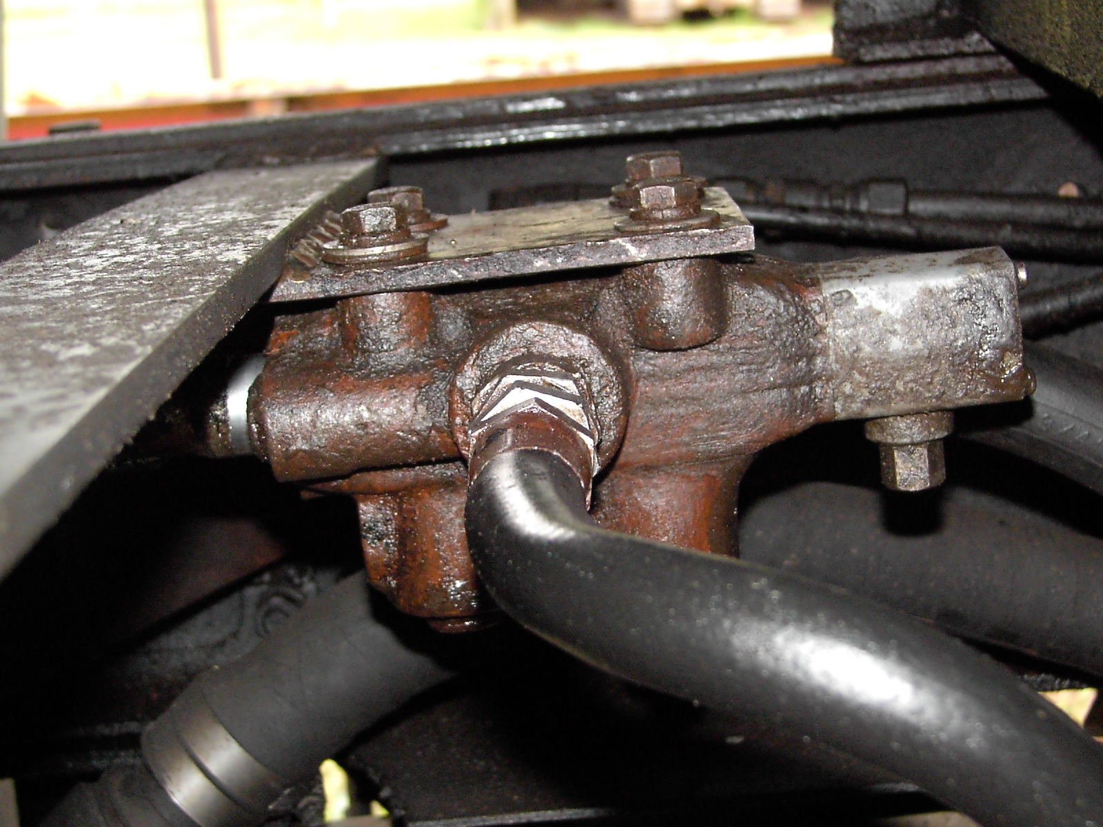

Having a similar issue on my 85 chevy c60 dump truck. The lift cylinder is SA with "built in reservoir". The valve is a Gresson valve, but cannot find any model number. With PTO engaged, bed lifts great, but when move selector lever to lower bed, bed only stops its up travel, and this is with the pto still engaged. As it is now, to lower bed, must disengage pto and then select the bed in the raise position and the bed lowers just fine. Hard for me to think this is correct plumbing. Any thoughts or suggestions would greatly be appreciated,
/ Gresen 550 #43
Also, this type of lift cylinder is serviced when extended or retracted? The service port is simply a "hole" in the top of the piston end of the cylinder. Raining just now, but will get some pics to help ID what valve this might be.

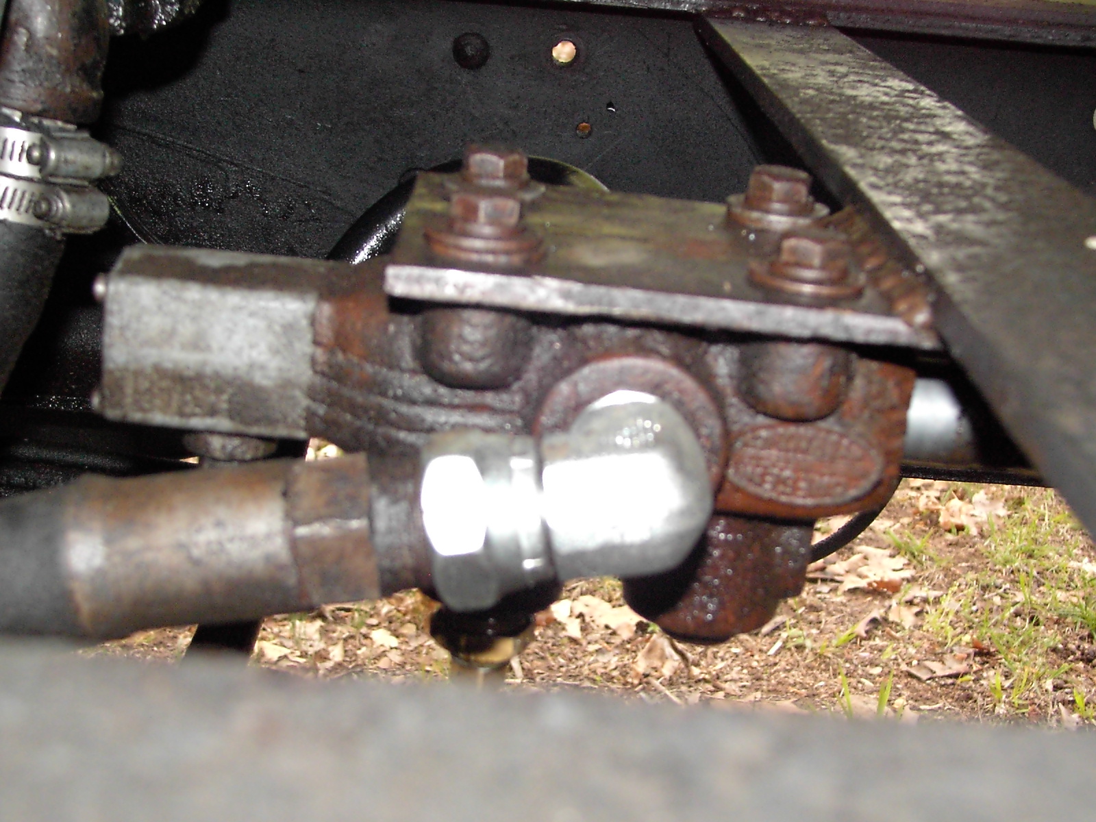

Hey JJ. Here is some pics of the valve and the way it is plumbed now. There is now, no "external " tank, only using cylinder as reservoir. Yes, there was an external tank before, even though the cylinder is of the "self reservoir" type, but when external tank was in the system, would time after time, blow out the gasket of the piston end "end cap", so I bypassed the "external" tank, and now, no blowing out of the gasket. Before with external tank in system, gasket would blow when piston reached the end of it's travel. By the way, there are no "port" markings, so I have no idea which port would be A, B, etc. and thanks so much for your time.

Your center picture shows both work ports plugged, with two other hoses connected to something.
How is anything working as cyl need the A and B work ports to function.
A single action cyl needs one of the ports to work, or it can use two just so the relief doesn't go off.
Something is wrong with that picture.

the center pic is showing the valve mounted inverted. The two hoses, one comes from the PTO and the other goes to cylinder. I did take the "cylinder" hose from its side mounted location and revered locations on the "bottom" with the "brass plug". Operation of the bed was the same.
Here is the plumbing - large hose from "cylinder return"(external pipe into base of cylinder), then to PTO, out of PTO to valve, from valve to cylinder.
You are calling the two ports on what is now the bottom as A & B?
/ Gresen 550 #49
What I see is totally wrong, but if you made it work for you then so be it.
What I think you are doing is, when you raise the cyl, you engage the PTO pump, which sends fluid trough the valve to the base end of the cyl, and it raises, and when you shut off the PTO pump, the cyl descends by pushing fluid out, back to the tank.
Anyway, here is how a SA cyl is supposed to work.
The pump in an open center system and is always pumping, and the flow is through all valves IN port to the OUT port, to reservoir.
An SA cyl is connected to one of the work ports and the cyl is raised by pushing or pulling on the lever to direct fluid to to one of the work ports.
When you want to retract the cyl, you push or pull the lever and that directs fluid to the plugged port and the relief sends that fluid to tank. It also allows the fluid from the SA cyl to flow out the same port it is connected to, to tank.
/ Gresen 550 #50
Thanks and yes, but from the pics, can you tell me which is "in" ports and which are out? There are no "bossed" markings, only the logo of
Greson Hydraulics. If the valve were right side up, there are two ports on top and one each side.
