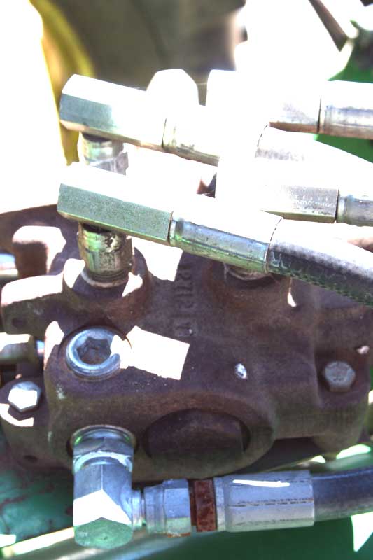

I have a 2-spool Gresen 2712 control valve on my JD3020 front-end loader. Does anyone know if that valve has power beyond? I need to add another control lever and don't want to swap out the whole valve if I don't have to.
I can't find any documentation on this valve and nothing in google either.
Thanks!
/ Gresen 2712 Control Valve power beyond? #2
Look at your valve and see if it has 7 hoses. Also look for letters stamped on the valve such as P,T.PB, PBYD, A,B.
Perhaps some pictures of the valve would help with ID.

It does have the letter "Y" stamped on it. I'll have to go count the hoses a bit later. Can maybe get a photo then, too.

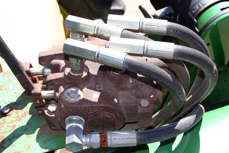

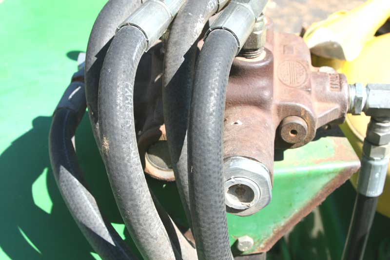

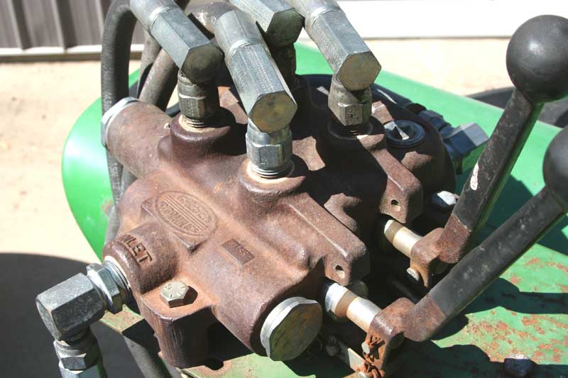

Here are the photos

Yes it does have PB port. It's the hex screw in picture #3 right behind the out hose.
