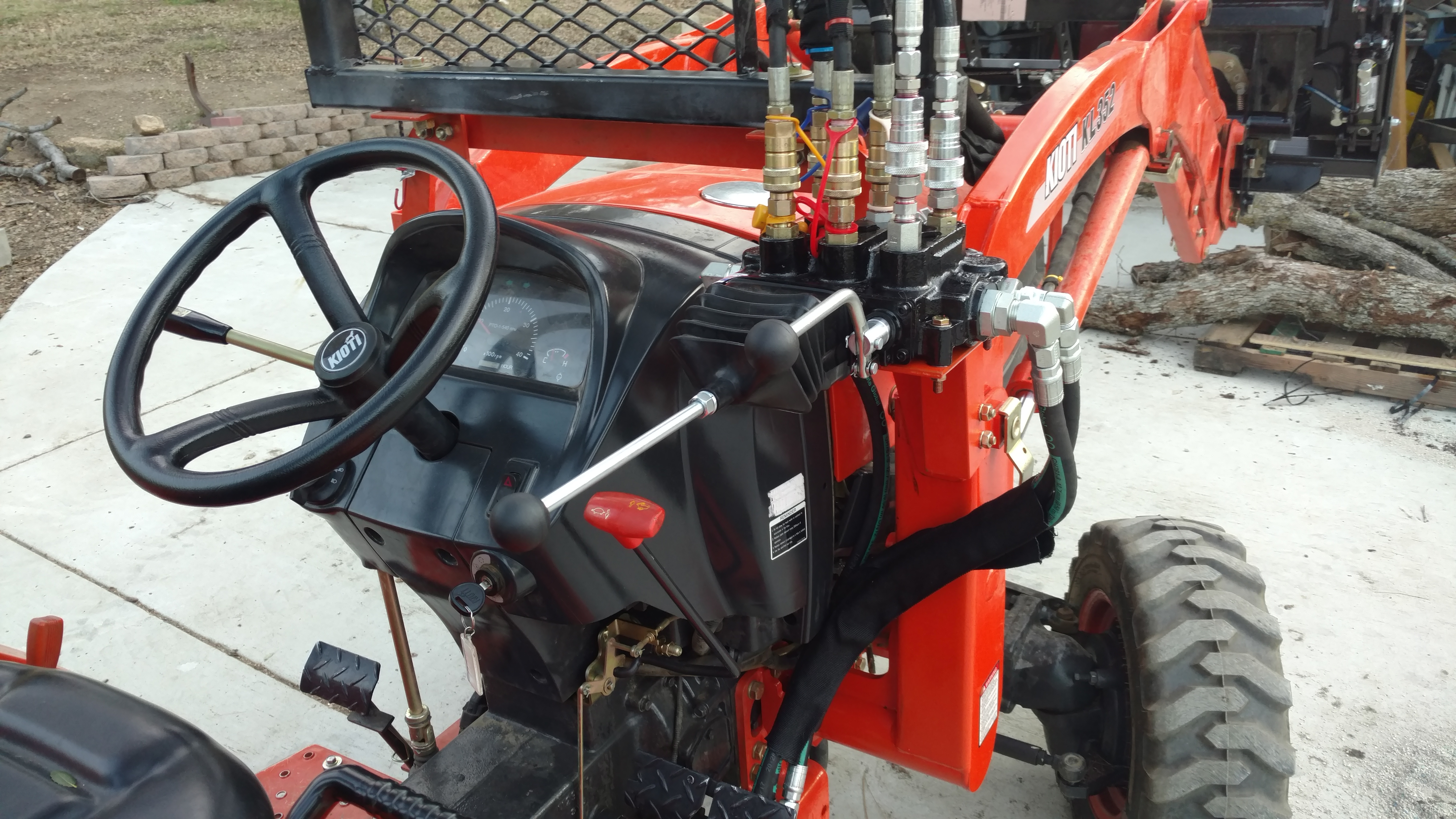

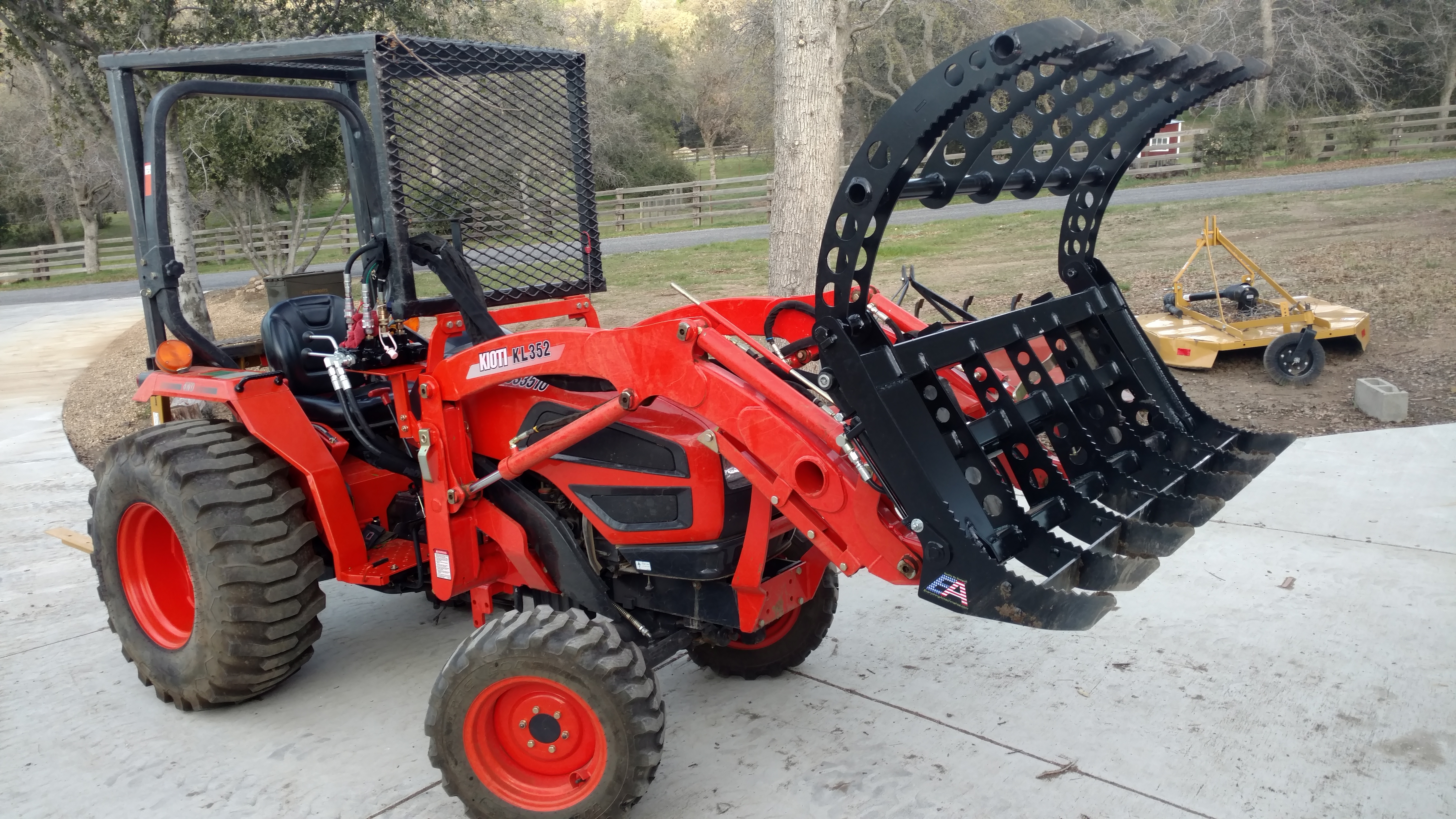

I have a DS3510, and damaged the factory loader valve. I was wanting to add a third function for a grapple, and ended up getting a massive 25 gpm capacity valve from Surplus Center. 3 Spool 25 GPM Joystick Loader Valve w/Grapple | Directional Control Valves | Hydraulic Valves | Hydraulics | www.surpluscenter.com
With all the adaptors and additional hoses, it cost about what a replacement valve from Kioti would have cost. The flow exceeds the pumps capacity, but that is not an issue. The handles are long enough to allow fine control of the bucket functions, and the grapple is fantastic.

I believe my KL1450 loader (DK35) uses a Prince LVR loader control valve (thought the KL1470 used the same valve, not sure)
My control valve has always worked very smooth.
Below is the valve and the parts pdf
