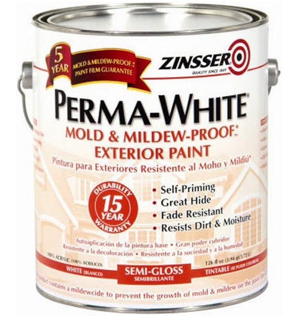

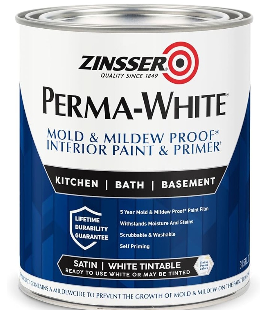

Perma White by Zinsser has solved many a rental problem for me…
I have not kept up with formula changes but in the last 15-30 years ago it was common to have problems in baths and closets with exterior walls… the Zinsser product eliminated it as long as 2 coats used.
Interesting that they don't call that bath and kitchen paint yet they show a bathroom on the can. They do label the paint/primer combo as bath/kitchen. Thanks for the link. Eddie mentioned an exterior paint, which might also be an option.
