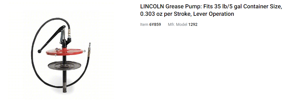

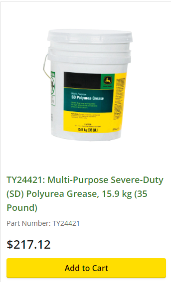

Ever consider having a growth mindset? honestly you have options that could save you money and get you the greese you want now to me we have given great options but you shoot us down.
your desired option is $$$$$ or unobtainable asI see it, but that 5 gallon bucket looks like a great option.
you put a 30 40 50 foot hose on that bucket... no more carring 5 gallon bucket. shoot you could mount it on the bailer and or bed of the truck, pick it up on day one and last day when it's empty.
additionally most bulk options have options to refill tubes, so you can still do it the way you want, just refill the tube. I've seen bulk options in 30 and 55 gallon drums too maybe not this greese but seen plenty of others
I wouldn't be shocked if that system had an easy way to bulk fill it via a port or line on its reservoir as well, besides just the tube option.
good luck
