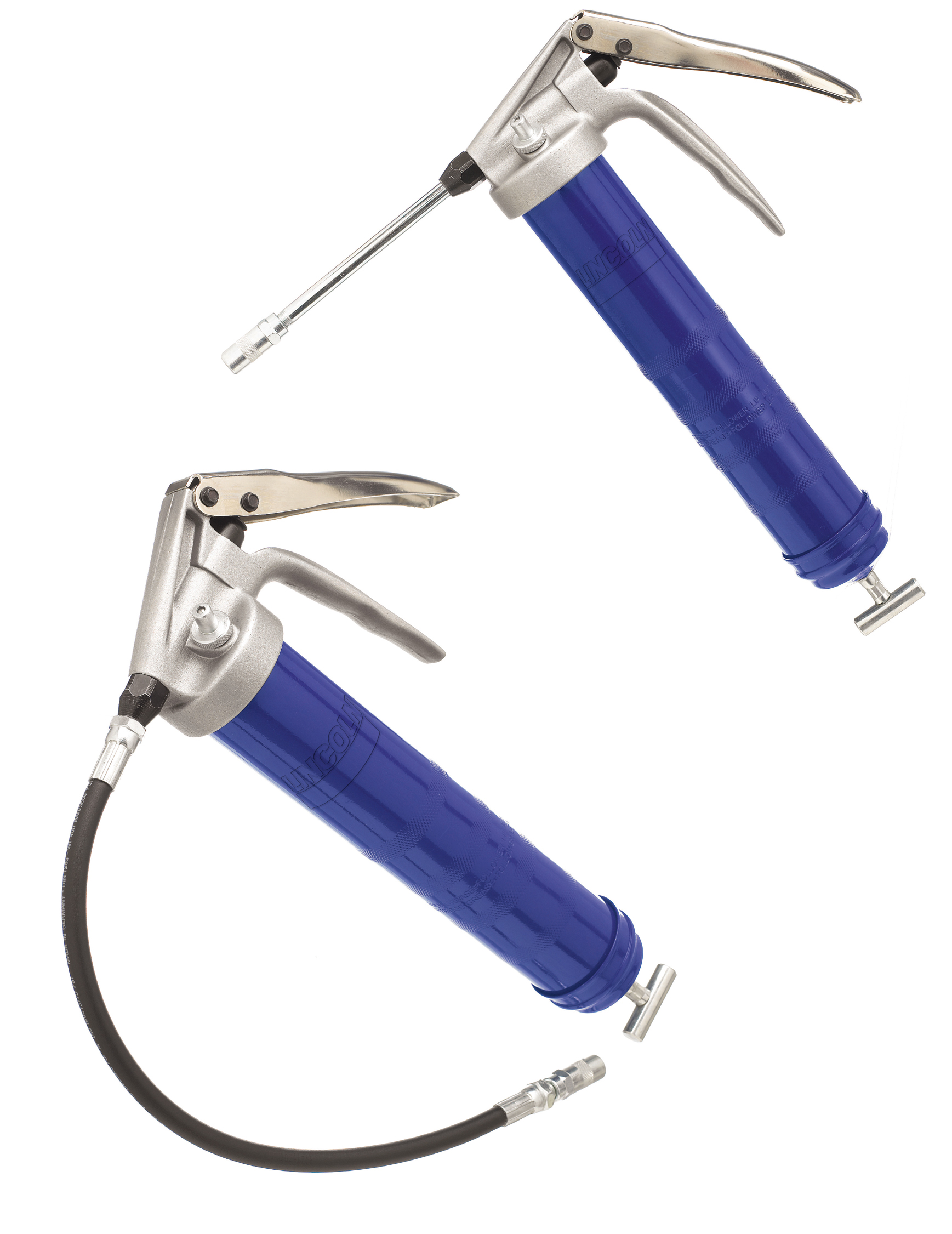

Ok, i'll chime in once more on this one.
Did the greasing last night, and it was no sweat. Not sure why I was complaining so much previously. Yes, I had to tighten and loosen the nozzle each time, but with gloves on and a good supply of rags it was no big deal. After 25 hours since the last time, almost every pivot point was still totally full of grease (as in, one pump and it was already squirting out), so that makes me feel a bit better.

I have to admit I knew about the adjustment part of the tip before this thread.
The part of changing the grease tube that was hardest for me was to get the plunger to stay locked out. Eventually I resorted to using a small pair of vice grips to clamp down on the rod; because the place in the end cap that are supposed to hold it was worn out (I guess I did not lube it enough) :D:laughing:.
I had a many a tube sent flying across the shop or field just picking it up to put the two halves back together.

On the tip of your grease gun fitting you may notice a knurled area on the very tip. It is knurled so that you may twist it to loose it with your thumb and forefinger. If you twist it counterclockwise it should loosen and that will make the fit on the grease zerks very loose. if you tighten it, it will be very tight. I often loosen it to slip over the zerk very easily, then tighten it a little while on the zerk to stay on by itself, pump in the grease, and then loosen it to easily remove. If you cannot get it to twist to loosen, take a pair of pliers or 2 pair of pliers to hold both sections of the tip.

I saw one "cheapie" that did not have the jaws and did not adjust, it had like a hairpin spring across the nozzle instead of the 3 or 4 jaws. Could you post a couple of close up pix of it? looking into the nozzle and a side view? maybe we could help
