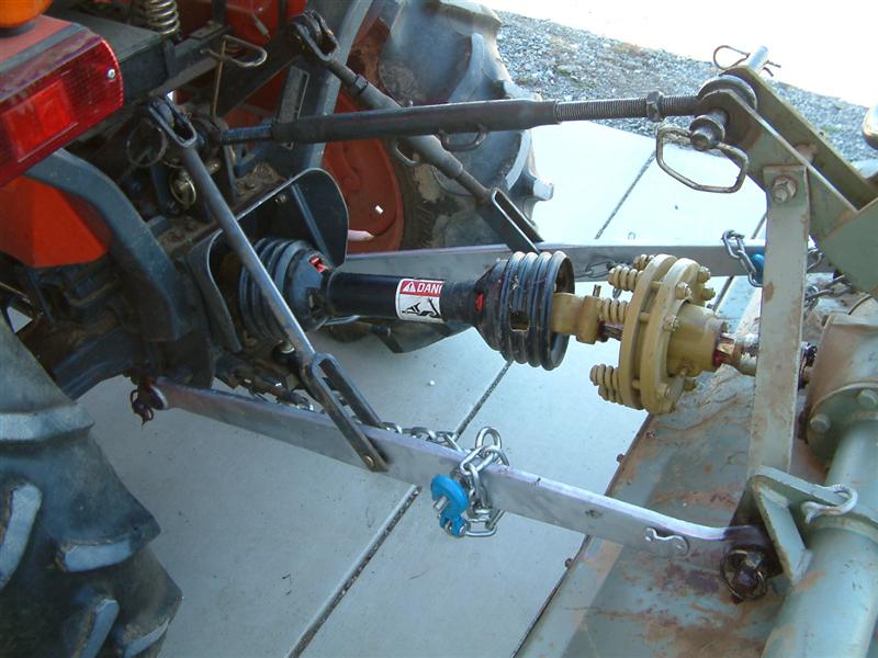

bought a gray market rottotiller to run on my JD 2320 yesterday and have a question about the PTO driveline. It is a fixed length shaft with a coupler and U joint on each end. The length is good but difficulty factor of installing is extreme.[2hr of fighting with it so far}also it doesn't seem to alow much up down movement without side strain on tractor pto any insight would be appericiated.

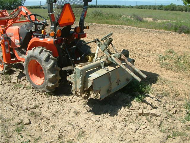

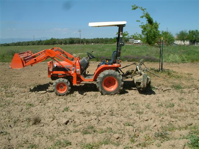

I bought a used Yanmar RS1200 rototiller (48" wide) and adapted it to my Kubota B7510HST about 10 years ago when I was putting in landscaping at my new house. I junked the pto drive line that came with the tiller and replaced it with a new drive line and added slip clutch since there was no shear pin on the tiller.
To make room for the new parts, I swapped the standard 26" long lower arms on the Kubota 3 point hitch with 35" long arms that I borrowed from my 1965 MF135 diesel. This lashup worked fine.
Good luck

thanx much Flusher have a dead MF2135 out back and with the added length maybe even a drive line and clutch. would have taken me awhile to get there with out you pics
thanks Greg
/ gray market rottotiller #4
thanks Greg
Glad the info was of help.
Forgot to mention that I had to use a short (6-8") pto shaft extender on the rototiller end of the drive line to keep the slip clutch from rubbing on the rototiller topside sheet metal. You can see it in the first photo between the slip clutch and the tiller. These jobs never turn out to be easy and straightforward. Parts never seem to fit together easily so you're always improvising. Such is the life of a farmer:rolleyes:

Nice cap, Flusher. Is that a commercial model, and is it a good size for your B7510?
/ gray market rottotiller #8
I guess so--that Yanmar is a used tiller from a rice field in Japan. It's 48" wide and covers the track of that Kubota B7510HST, so it's the right size in that regard.
It worked OK for my landscaping job and for tilling the vegetable garden. It's not a particularly heavy duty tiller however.
