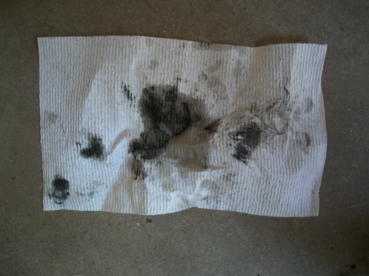

I hang a magnet from the hyd tank filler cap down below the oil level, but not on the bottom. My machine requires a 50 hr filter change so I have to check top off oil level and I clean the magnet. Here is what the towel looks like (pic attached). You can decide if it is worth the trouble on your machine.
Hanging a magnet is vastly different than arranging lots of magnets on the floor (for example).
Magnets cannot pull tiny particles from the fluid from all directions. It catches only the particles dropping past very slowly, vertically downward from above (while the oil is still).
Your method is a worthy observation. If you saw flakes, you would "know" something! Seeing only the black dust is "no news is good news".
But for catching and sequestering the black dust to never re-circulate, it makes more sense (to me) to create a large "quiet area' on the bottom (of a flat reservoir). Which is their ultimate destination anyway. Just setup the conditions to "hold" them there so they cannot be re-stirred, recirculated.
Who cares if you carry the trash around everywhere you go for the whole 1,000 hour interval? If they're out out of the fluid flow, --->that's your benefit.
This would be easy to make, and the effort minimal, in my mini-ex which has a flat bottom rectangular reservoir. I don't know how to get this benefit on the tractor which is a cast shape with no access cover.
