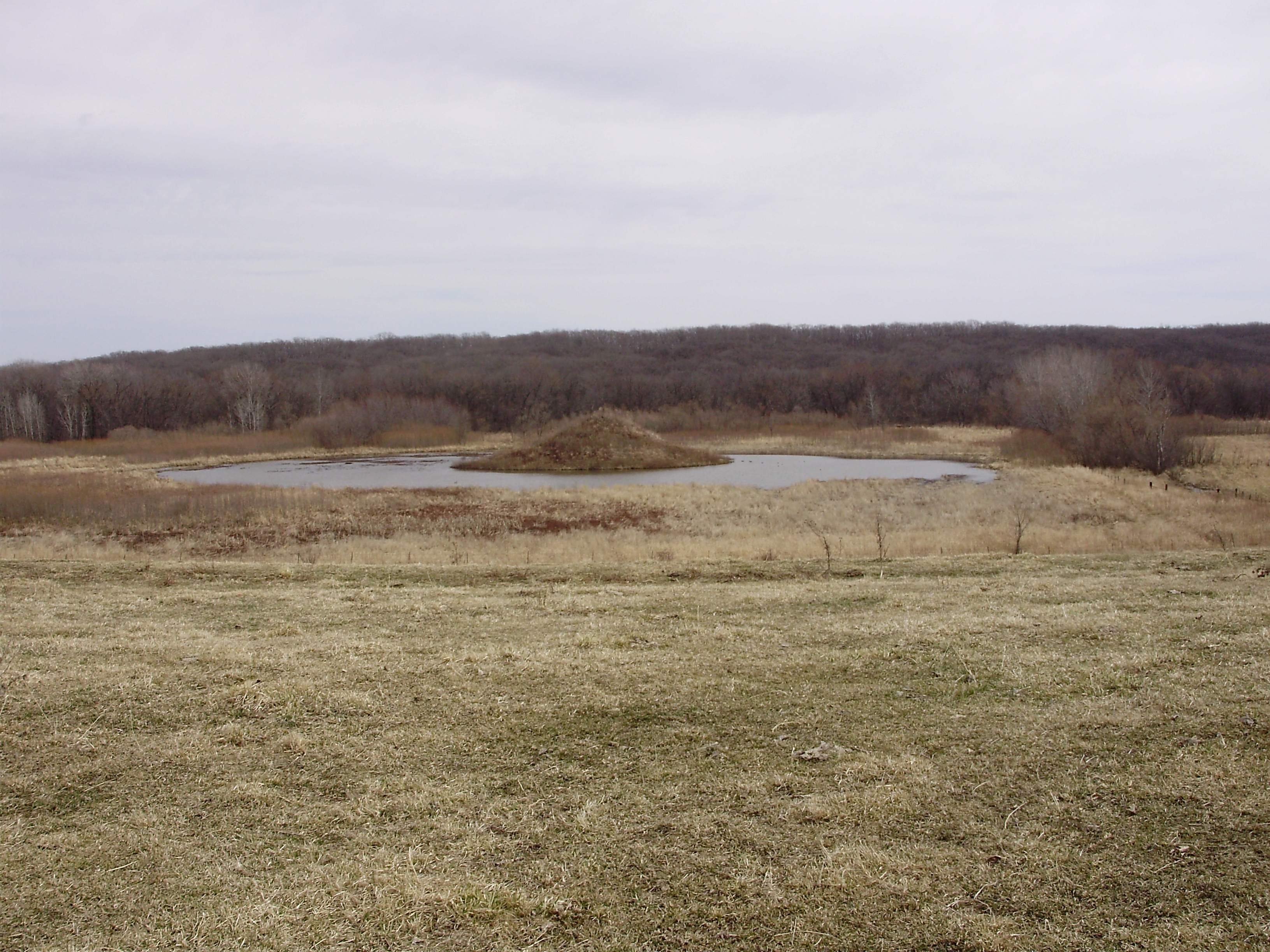

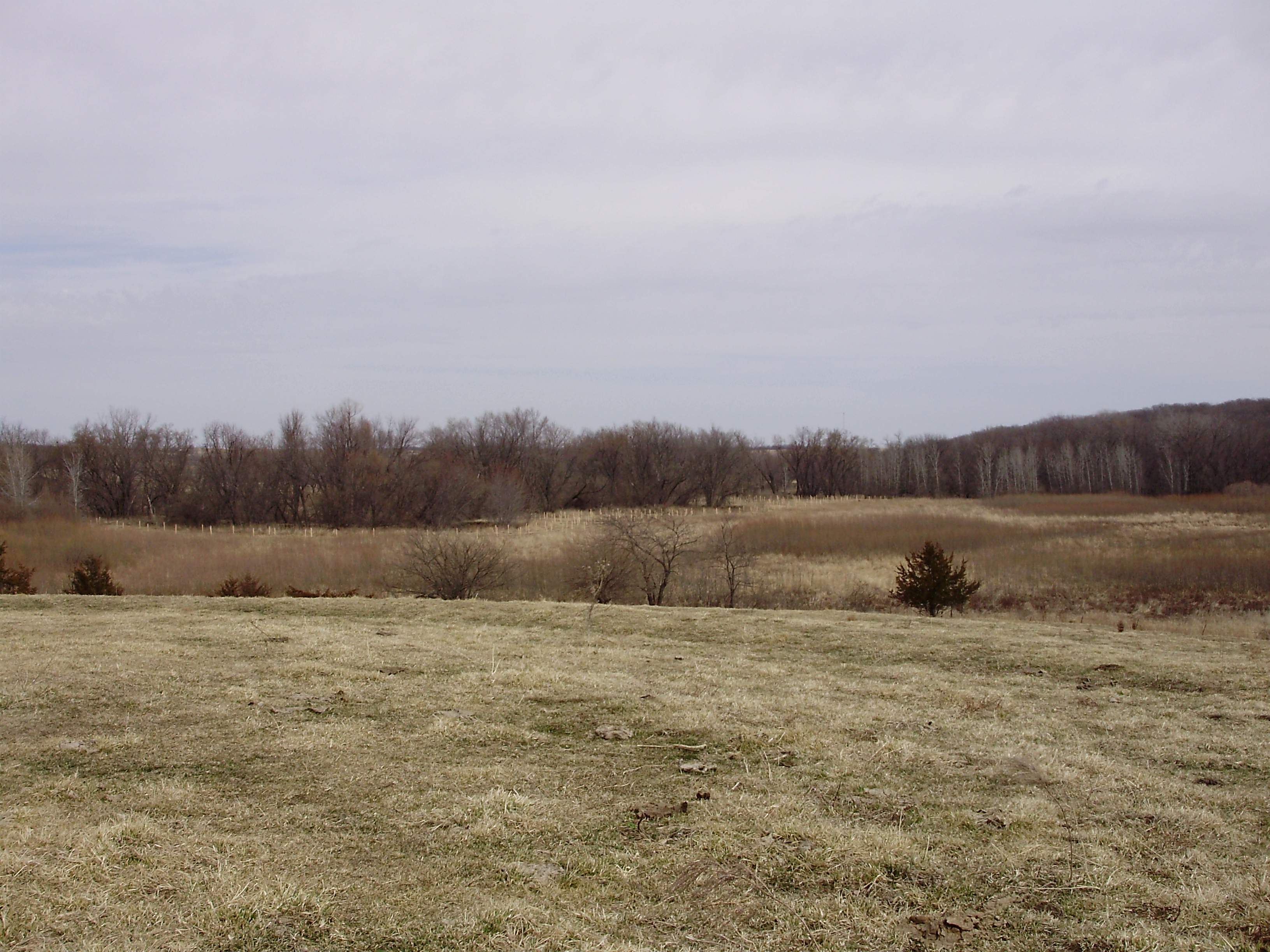

/ Gravity fed water supply #14
I will be following this thread, I have a spring on my place that I would like to use, but it is down hill of my building site. Keep the ideas coming.
Picture looking out from building site.
Gordo
