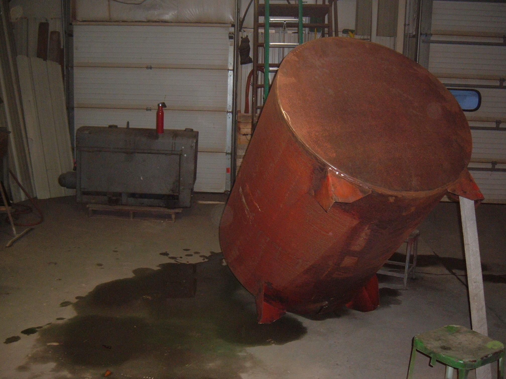

I agree, convenience is the only savings. I had a hole eroding in this one about the size of pencil eraser. Only hole in it. Steamer it out, cut a hole in to look, bottom as good as new, very surprised for a 50 yr old tank,,, new except for 1 spot.

How loud is that Lincoln with a Cherry Bomb on it?

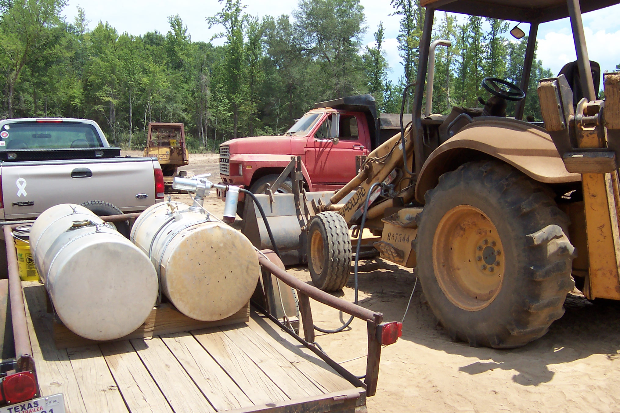

Just get a 90 gal transfer tank with a 12v or hand pump. Put it on a wood frame so you can lift it with forks and put it in a trailer/truck. Take that to town and fill as needed. Get aluminum...it wont rust.
   / Gravity Farm Diesel Tank, is it worth getting one. #32
my last 100 gallon tank with a 12v pump cost me $300.00 used. was too much for what I would do in a year so went to a 50 gallon tank
   / Gravity Farm Diesel Tank, is it worth getting one. #33
This^
I bought a 105 gallon L shaped tank with 12v pump at an auction for $200.
CT

I got tired of hauling cans so got a 100 gallon tank, mounted it in a 5 x 8 utility trailer I rarely used, and went with a 12v electric pump. When I did that, I was using about 300 gallons or 3 fills yearly. Then I went crazy helping farmers and started my own. I put a second 100 gallon tank in the trailer. Last year I sometimes burned through over 300 gallons weekly. Very handy as sometimes my equipment might be as far as 15 miles from home. I’m glad I went the portable route no matter how much or little I use.
