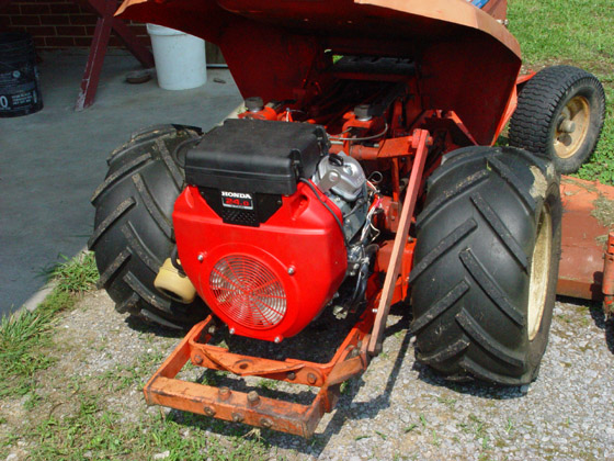

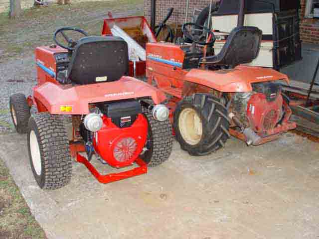

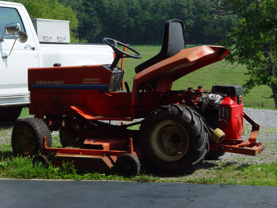

I have done repowers on 8199 KT
Here is a link to a repower of a 16 to a 24 Hp Honda.
You can repower with any Engine with a 1 1/8 dia X 3.500 to 4 .00 long.
the chose is yours.

I have one and my brother has two I have changed over for about 3 to 4 years ago
So far they are doing good .
What town do you all live near
I am 1 1/2 mile off 75 Exit 33Charleston TN.
I like The Honda I would never say it is the best
I got my engines at Nothhern Tool Chatt. TN.

I knew i needed a engine 1 1/8 X 35 to 4. long.
I found a 24 Hp Honda with a 1 1/8 X 3 3/4 long.
I decided I would Get it and have a adapter made.
At the time I did not know that the 32164 adapter plate .
off of my 19 series II would work .
The only need was to fill with a gasket about .065 gap in the counterbore.
I put the 24 Hp Honda on 3 years ago and am very pleased.
They are a power house.
