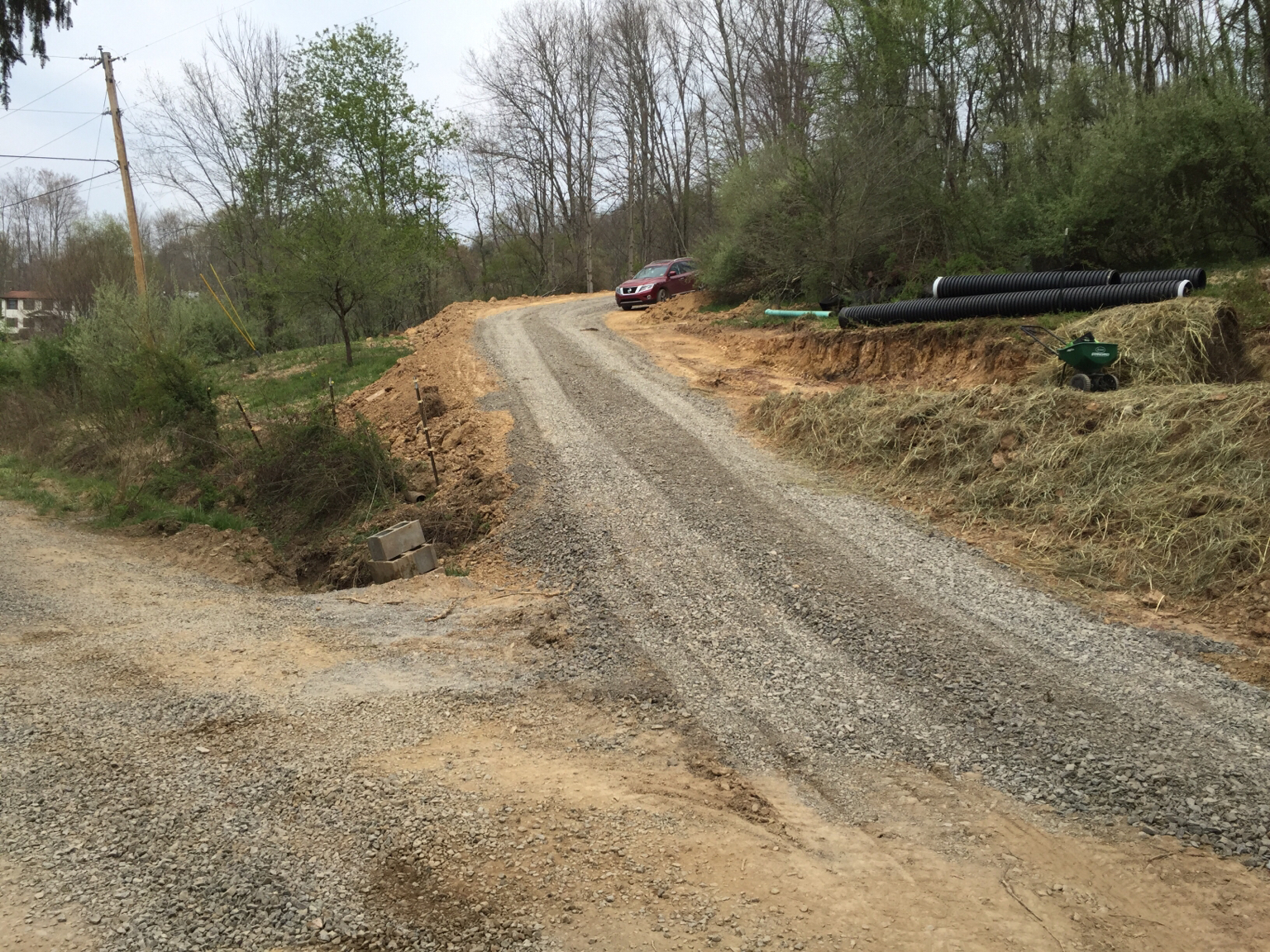

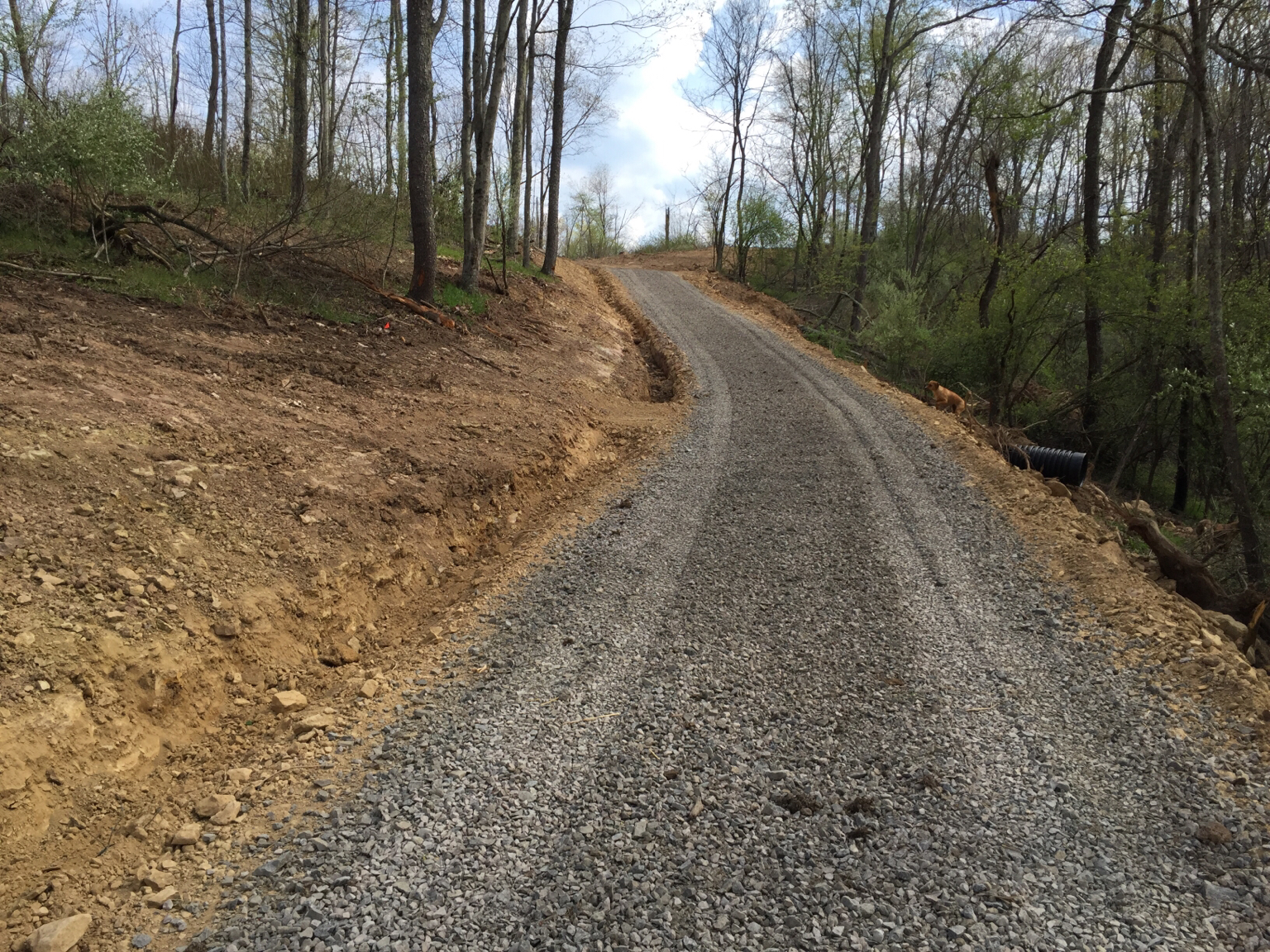

If it's already packed and an established road then I would go with 1.5" crush and run. Unestablished road go with 3" the first time. We just built a house and had to have 7, 25 ton loads dropped on the driveway and it's still soft in one spot on a steep section. It's been graded a few times as well. I have yet to come across a driver not willing to tailgate it. I would say wait for him to show up, give him a $20 bill and he'll do it. If you tell him you want it 2 inches it will come out closer to 4 and hope for a wet day to pack it.
Photos of virgin dozed driveway with first layer of gravel tailgated.
