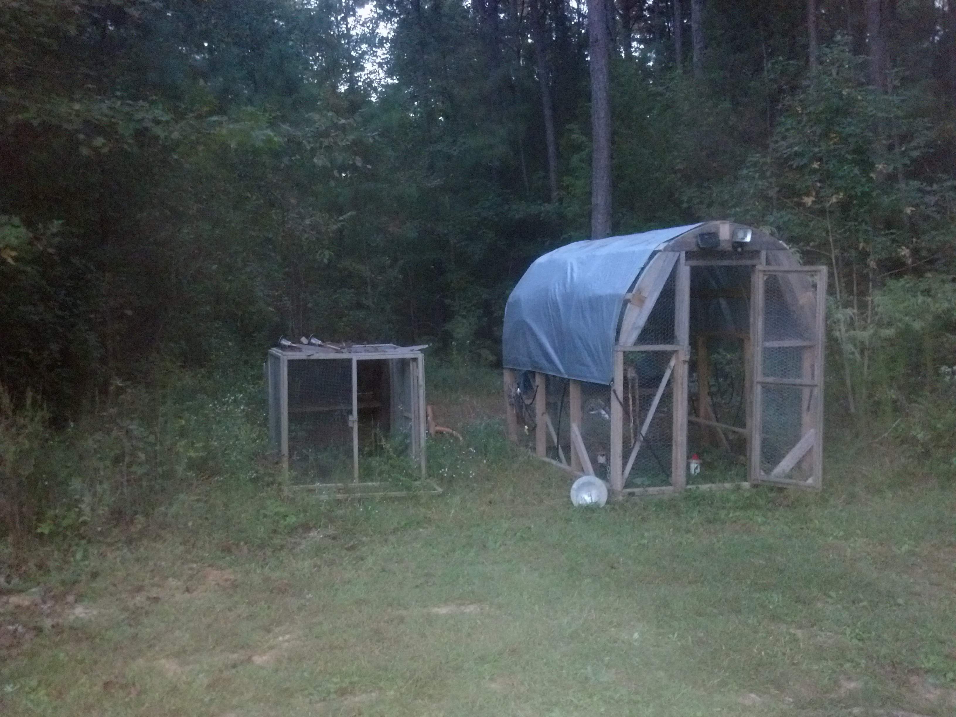

Thanks for all of the suggestions. I'm going to order the ABC tomorrow. The laddy at the gravel pit calculated I would need 12 tons. I might see what the truck holds and order some extra as I think delivery fee would be the same if the truck is half full or fully loaded. The price is $14.50/ton which I don't know if that's a good price or not. I don't have to worry about any white marks on the black top as this will be at the edge of the woods.
