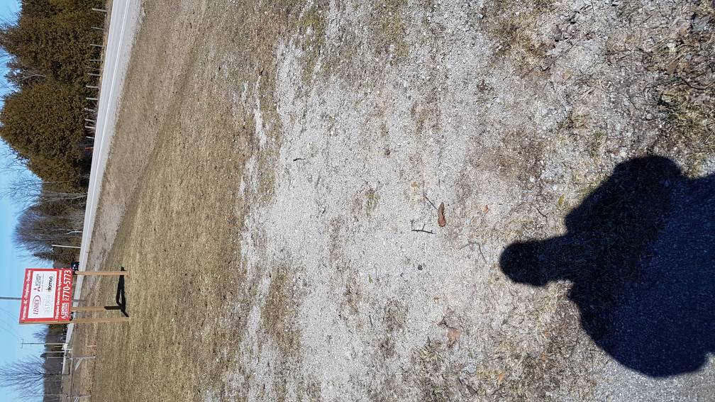

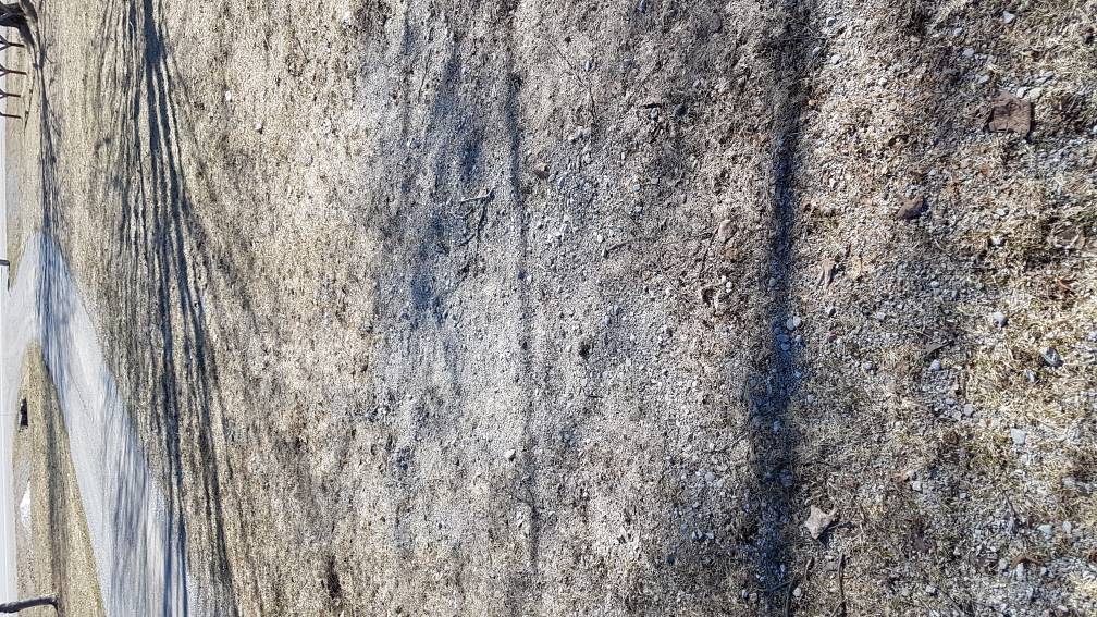

Well the snow is all melted away now and I'm left with piles of gravel on my driveway. Before I bought my tractor I was paying and Contracting Company to come in and blow the snow. A few times he used a plow on the front of a truck and some of my driveway ended up on my grass. Anyone have any advice on attachments to get the gravel off? 20170401_150521.jpg

I'm with Jack - rake and shovel. Any of those rotating brush thingeys will tend to tear the snot out of a damp, soft, spring lawn.
/ Gravel on lawn #7
Power Broom for the front of a tractor or skid steer. Or a rake and shovel.
We had a company push snow with his big truck off a gravel parking lot. He got pretty zealous in the spring when the ground was soft and had big piles of gravel all over. After we cleaned it by hand the next year we complained about it and he brought out a power broom which worked great.
/ Gravel on lawn #8
I start out with a hard rake, then switch to a leaf rake . last and the best is my shop vac. gets the rest of the lose rock, this does a great job just don't let it fill up to heavy to lift.
/ Gravel on lawn #9
Power broom than good raking.
/ Gravel on lawn #11
Handheld power broom on an Echo or Stihl weed eater stick. FORGET 'rack', rake or shovel.
ALL NorthEastern yard guys use the handheld power brooms to remove gravel, rocks, sand from winter snowplowing from lawns. And on everything except standing water lawns the hand held units won't rip up the lawn at all. Regular rakes are much rougher on the grass than any power broom. I've used one on my lawns every year for the last 20 or so, and virtually no damage. I usually turn the unit over and run it so it's pulling the stones toward me and then walk backwards to bring the gravel/debris to the driveway edge. I find it easier than trying to push the stones forward. Much less stress on the back.
Note: it's called a power broom , but in fact it's actually a power paddle wheel, with rubber flaps where bristles would otherwise go on a power broom type tool. BUT one can buy a power broom head as well, with actual stiff nylon bristles, for maybe using on sidewalks or similar. All I know is my paddle wheel power 'broom' shows no wear from being used Spring/Fall for about 20 years or thereabout.
On a tractor, a power brush/broom would also work, but it might be harder to keep from damaging a wet lawn due to the tractor's tires/weight of the tractor, etc. But, if one could rent one and use it judiciously, then it could work as well as a handheld one. JMHO on the tractor based unit; haven't ever tried that particular tool, but I bet it's not cheap to rent or own.
/ Gravel on lawn #12
Most of these use little hammers that throw the gravel forward without contacting the grass much. I don't have one but did get to try one out at a home and garden show this year, neat tool imo but pricey.
/ Gravel on lawn #14
I believe I would call the person you hired to clean it off.
/ Gravel on lawn #15
Neighbor took an old root tiller. Took off the tines and bolted on several push broom sections cut in half. Works well an does not tear up the grass
