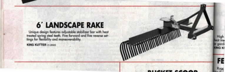

A landscape rake is my prefered choice for grading. One with wheels and that can be angled to pull the edge gravel in is ideal. You'll still have to use Roundup or something to kill the grass and weeds, but to me it simplier than a wholesale redo of the drive caused by extensive uprooting and tilling.

Hi. I don't really know what a landscape rake is. The only image that jumps to mind is what I think is a hay rake, but not even sure about that.
My purpose is just to disturb the top layer of the driveway enough to disrupt growth of grass/weeds. I'm not real compulsive about grass. I consider that I'm mowing weeds that just tend to look like a lawn when mown consistently. But I have a fairly broad driveway area I'd prefer didn't have vegetation on it, and I'm looking for simple, effective, cheap, one time only expense ways to do the job. I'm rural, and if I lived alone, I'd probably ignore it all, except for a once or twice a year 'bush-hogging'. I'm turning into a grumpy old hermit type, except for the civilizing influences of SWMBO<G>...

Re: \'gravel drive de-weeder\'
In some parts of the country they call it a rock rake instead of a landscape rake.
It has shorter teeth (if that is the right word) and they are close together, it will get the rocks out of a plowed field, or level out a tilled area for a lawn or driveway, much better than a blade.
Most can angle so you can rake your gravel drive and not push the rocks out into your lawn.
The only way not to have grass in your gravel drive, is to pour a concrete drive. The gravel make a pretty good base.
