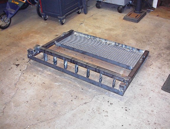

Here is drag that I made for a buddy that has a scarifier bar that can be removed when not needed.

Here is the same drag with the teeth positioned out of the way.

Thanks, folks, for your replies. I'm a little surprised by how many of you opt for a chemical method. I'd expect you to be looking for opportunities to build stuff like I was suggesting<G>.
I live in an agricultural area, and suspect I'm subjected to a lot more chemicals of unknown effect than I care to think about. So I stayaway from that stuff if I can. That said, I used Roundup to kill grasses in spots where I planted some trees a year or two ago, so it's just a preference, not a big deal.
The one example of an implement like I have in mind was interesting. Has it been put into use? How did it do? what kind of weight was required to make it 'dig in'? What were the scarifier prongs made from? Any particular dimensions? Thanks, again, for your replies...
