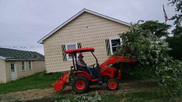

only 4.5 deep??? Most in these parts have to be 6'+ but at 4.5' I would not have a problem using a b26 I would get a grave bucket. google it and you will see a few companies make them. Also get the quick attach buckets as in a really dry time or near a tree you may need a smaller bucket to get it dug. You most likely would have to reset one time to get the full 8' reach. Attached are a few photo's of putting a drain system around my house which was 8-9'deep it can be done with a b26 but about 20' per hour or less at that depth using a 12" bucket. The larger bucket would have went faster.
