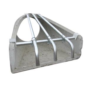

I have a culvert thru a wooded area, 30 inch concrete, it plugs, and my gravel driveway washes out. There's a lot of ideas on Google Images under "culvert grates".
This month it started to rain hard as I was crossing it and I checked for the usual debris and it looked OK. Back home an hour later and it was plugged-gravel drive was washed out. Digging it out later, a heavy stick had washed down sideways and was spanning the opening. Smaller sticks and leaves are then blocked by the stick. It's happened like that 3 or 4 times. So in my case, periodic preventative cleaning won't solve the gully washers.
I like this concept of slat arrangement (although their cement housing is overkill for mine) Those sticks that are just the right size to block things either get captured or turned. The angle slats might force sideways sticks upward and there's more area for flow. I think a smooth slat would be better for this angled design than rebar.

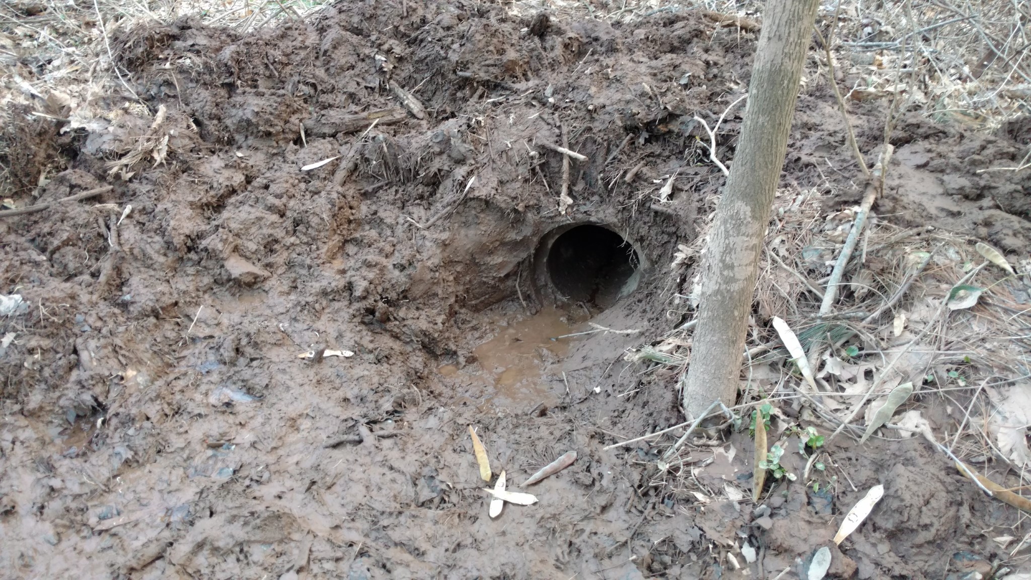

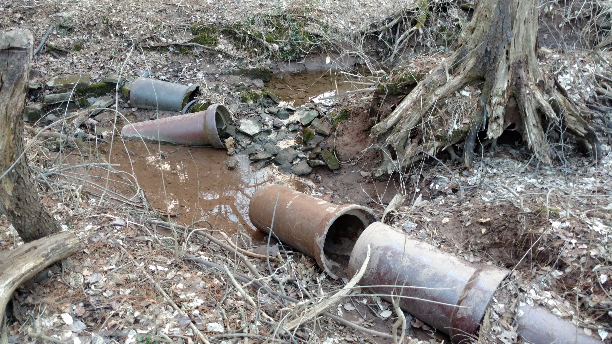

Thanks for the feedback so far. Here are some photos. I said clogged before, but actually it was buried. My plan is to dig it out further then build a stone headwall, similar to what jmc attached, but...stone. Also, you can see from the outlet that its been eroding back real bad. I'm not sure yet if I'll try to reset the last few peices or just accept it how it is, but I'm going to build an endwall with a stone apron and gravel/boulder bed to help dissipate the energy. Or at least thats the plan....
Inlet: It was really hard to capture this in photo, but its a 15" inlet that was buried in mud
Outlet:

that first picture looks like big foots hand print on that tree :D I like JMC idea or something similar
   / Grate for Drainage Pipe Inlet? #10
After seeing your photos Id just clean up all around the opening and leave it open. Expose the ends of the pipe and don稚 allow overhangs of soil, plants, roots etc. It looks like it gets seasonal use only so I wouldnt bother with a grate as you will end up having to clean that too after it gets overgrown with grass etc.
If its open you can easily get at it with a backhoe. Grates have to be cleaned by hand.
