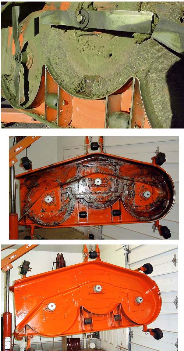

Does anyone know what works on keeping the grass from sticking to the bottom of the mower deck? I cleaned mine the other day and used the oil/diesel mix, and after cutting my 5 acrs. twice I had to do it all over again. I got about a wheelbarrow full. I have been cutting it in the late afternoon when it is dry and I am still getting the build-up. I am going to try cleaning it real good and repainting the bottom, then use SLIP-PLATE on it. Has anyone had good luck with this stuff, or am I wasting my time? Should I do something else? Thanks for your help.

I've had good luck with WD40. I buy it in the gallon cans and spray it with the little hand pump sprayer that WD40 makes. I do an occasional pressure wash to remove any buildup. I have the 60" and haven't had any major problems with the grass sticking.

Forget applying anything.
Keep it dry and nothing will stick as bad as your now experiencing.

Von,I would recommend a set of Hi-Lift blades.Have had a set on our deck for 3 seasons now and would'nt be without them.The blades not only help pick up the grass that your front tires track down,but also blow the clippings out the discharge much better.Don't have a whole lot of build up under the deck,unless I run over some very wet stuff.

High Lift Blades for Kubota 72" MMM. Kubota part # 33097-88890.Total cost,about 36 bucks,give or take a little change.

I had a Ford 72" rear finish mower that was made by Woods, I would clean it about twice a season. It did not have the problem that I am having now. I think I will look into the high lift blades and see if it makes a difference. At the price of $36.00 I can't get hurt too bad if it doesen't make a difference. I will just have an extra see of blades. I will let you know how it works out.

Well after cutting the yard once I got a big buildup on the bottom of the deck again. So I used the pressure washer, cleaned and repainted the bottom again. I will use the slip Plate and see if that works. Next step is the high lift blades if the Slip Plate does not work. I hope the attached photo file is not too big.
