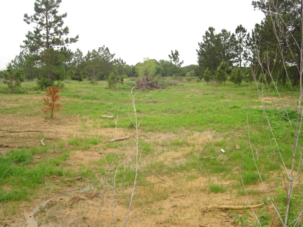

That is what I did also, I built a pad for a house and cleaned out a ditch. To keep it from erosion I planted rye grass and I also mix in some burmuta grass. I did this a couple of years ago and it worked out great. Here is a pic of just 1 1/2 months growth.
