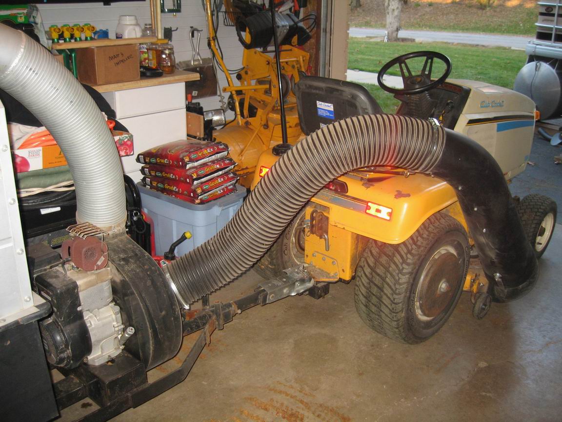

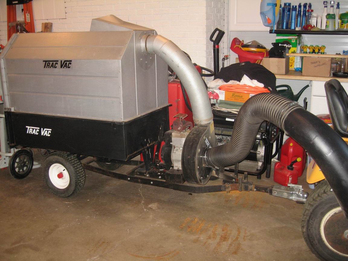

After not finding ANY grass catchers for the 1864 model listed on the CC website, I too checked out the 1862 section and found p/n: 190-335-100, but I'm not 100% sure that that was the original part number that matches the original triple bagger I've got (the model sticker on my grass catcher is LONG GONE and there are no other numbers listed anywhere on it). I suppose it doesn't really matter since the 1862 and 1862 are for-all-intents-and-purposes the same machine as far as most accessories are concerned. I was looking for the grass catcher chute so that I could adapt my existing mower deck boot to the pickup hose on the Trac Vac I just bought. The factory CC grass catcher deck boot is FAR superior to ANYTHING else out there in the aftermarket. But I need to go from an 8" mower deck discharge diameter down to a 6" pickup hose diameter on the Trac Vac. To accomplish that I was going to buy a new factory CC chute and taper it down gradually from one end to the other (8" at the deck boot down to 6" at the Trac Vac pickup hose) over it's full length. That way I could minimize/eliminate the potential for clogging vs. using the short 8"-to-6" reducer/adapter available through Trac Vac. That's the idea anyway.

Thanks for the help. Here's the finished project.
The finished setup worked-out better than I had hoped and made the process of fall cleanup VASTLY more efficient. I went from 6 hours using a rake and leaf blower down to 2 hours with the powered leaf vac and remote suction hose extension for clearing-out the landscape beds!
