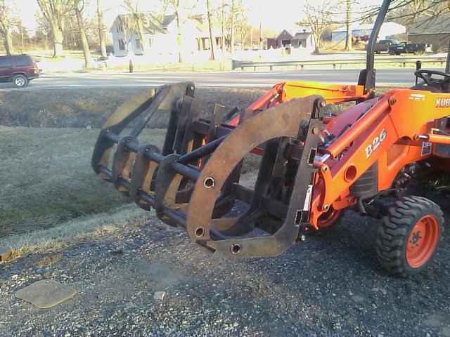

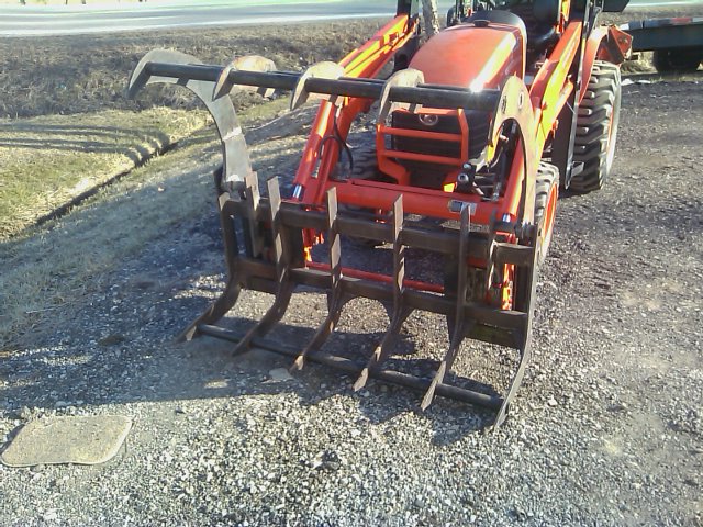

Go with the kubota 3 function kit it is a simple install and works fine. It was included in my price but not installed. I built a 50" or so grapple for mine. Go with an open grapple so you can see what your doing. Something like in my photo's.
I could not begin to count how many semi loads/acres of trees I have moved with mine. Also the hydraulic thumb on the hoe is a must.

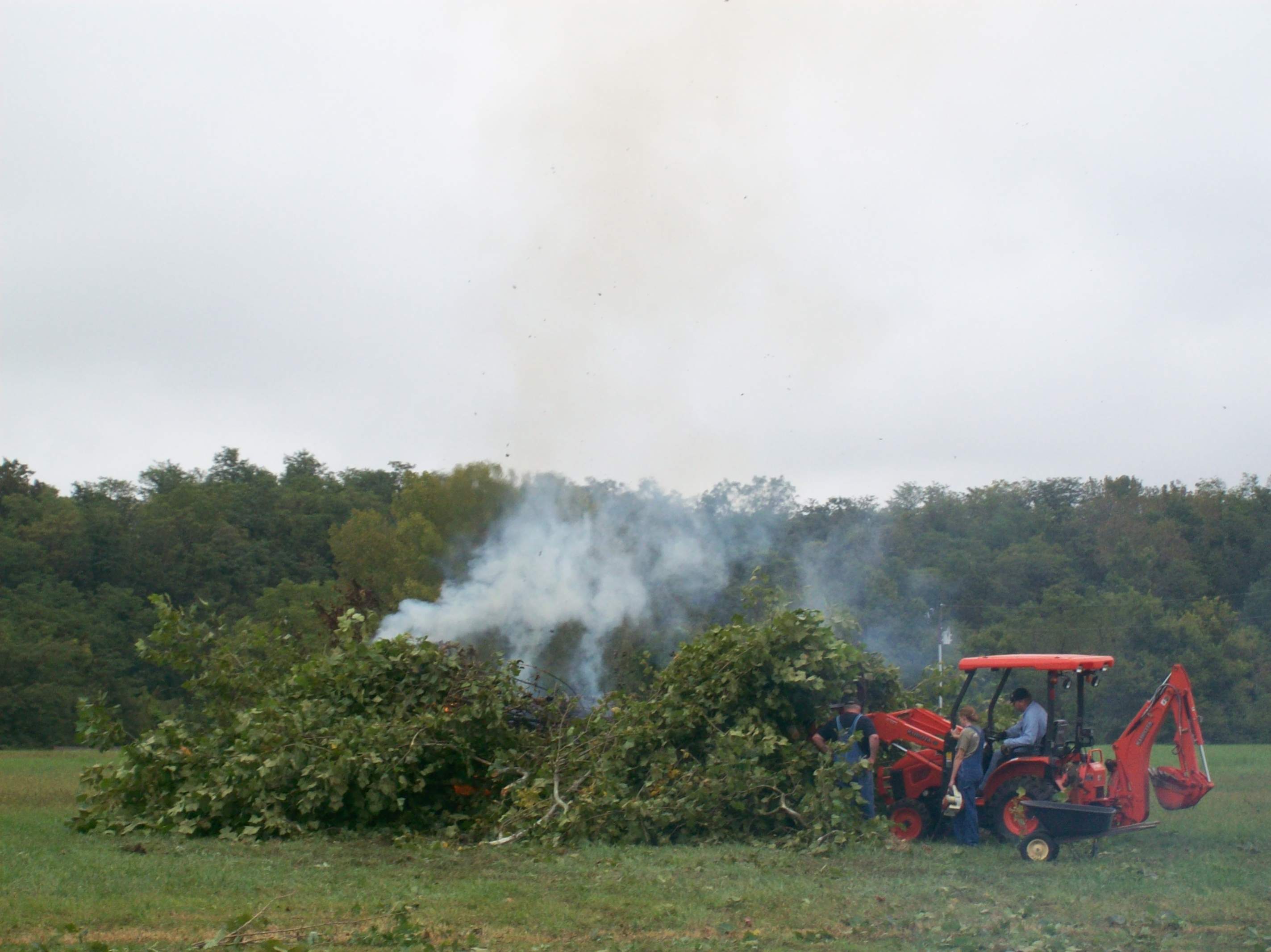

I have had a lot of burn piles over the years cause I had the place logged, Stupid gypsy moths. What I learned early on is the pile disappeared real fast with a leaf blower.
I use a 8hp little wonder. It also cuts down on the smoke. Try it you will love it.
Thanks again
   / grapple #14

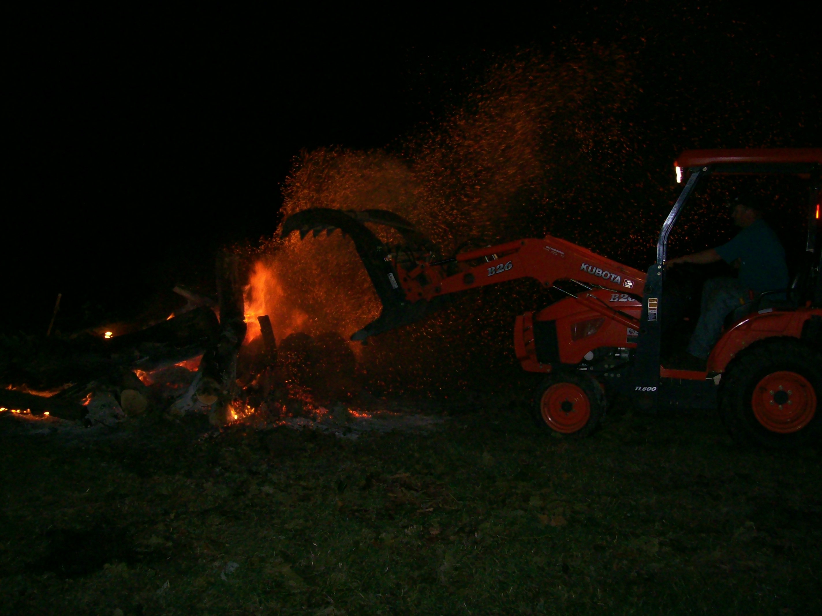

That pile in the photo took about 3hrs to cut down and stack and I use leaf blowers and a very large furnace fan that had a 36" cage on it to keep a clean smoke free burn. That pile burn in about 6hrs with about with 1qt of diesel fuel and a hand full of straw.
