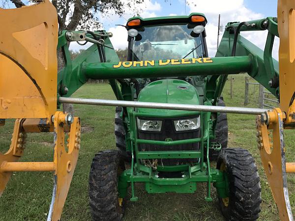

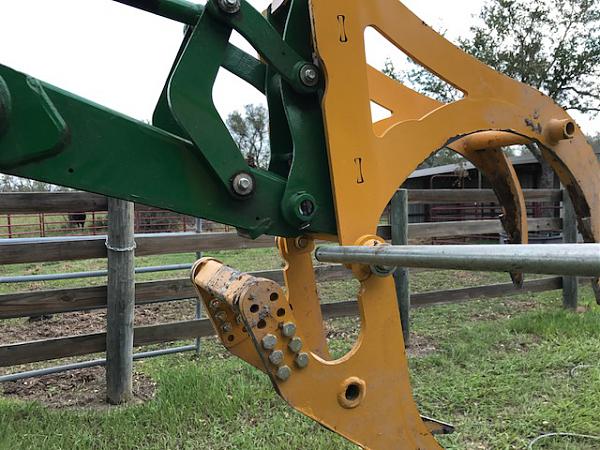

The fear with these is that the two "grapples" are not rigidly linked together, so they can twist when picking up uneven loads. A guy on the GTT forum tried one and the center "timing rod" between then two sides broke- that means the loader arms where flexing.
Something I wrote in that thread, there are many good points discussed too.
The issue of "rigidity" as we are discussing comes from the fact that with this implement attached there is nothing tying the two arms of the loader together anymore except for the round tube between the arms. With the bucket, forks, or traditional grapple attached the implement itself helps to tie everything together. Will this be enough? Only time will tell.
