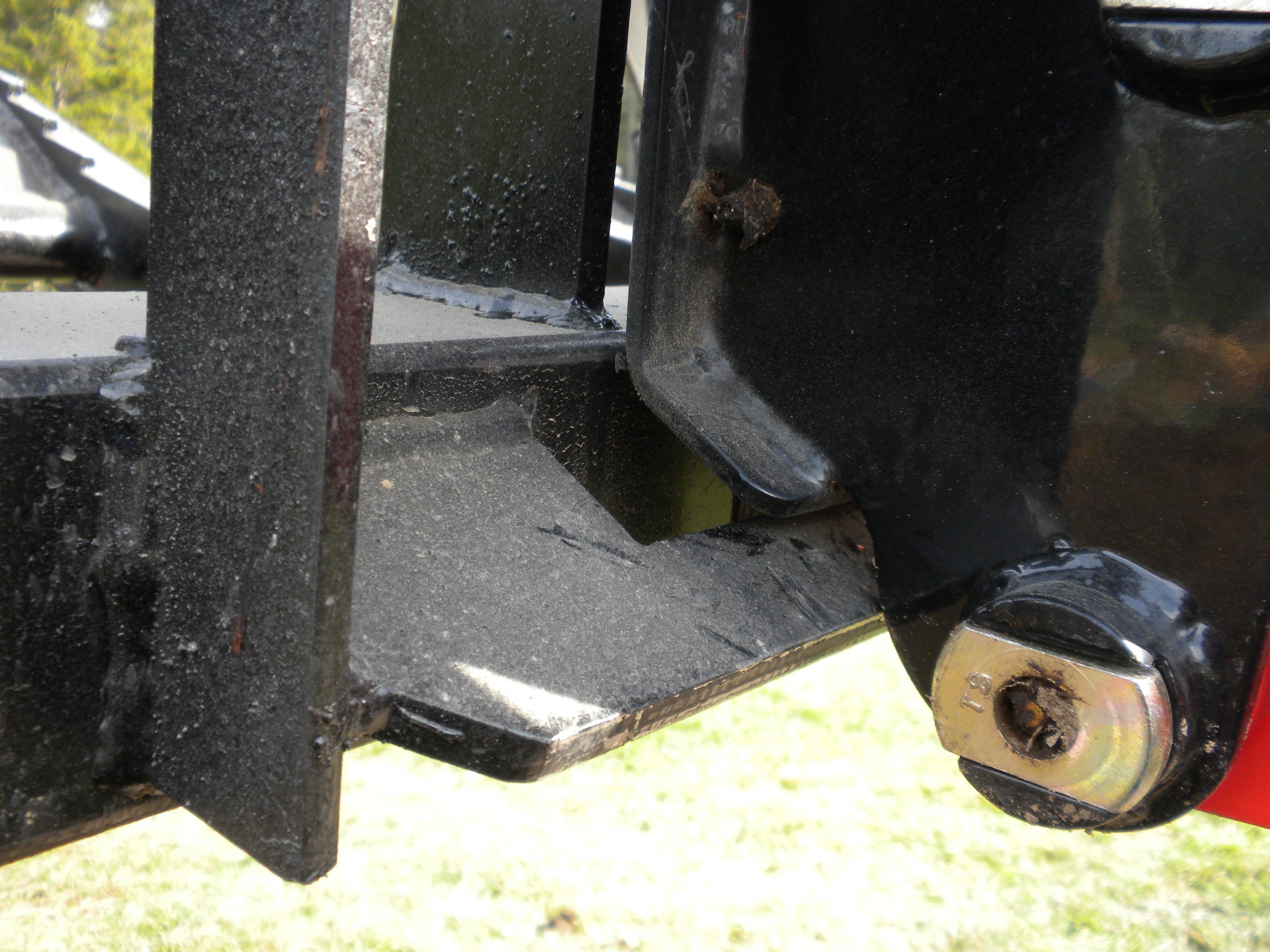

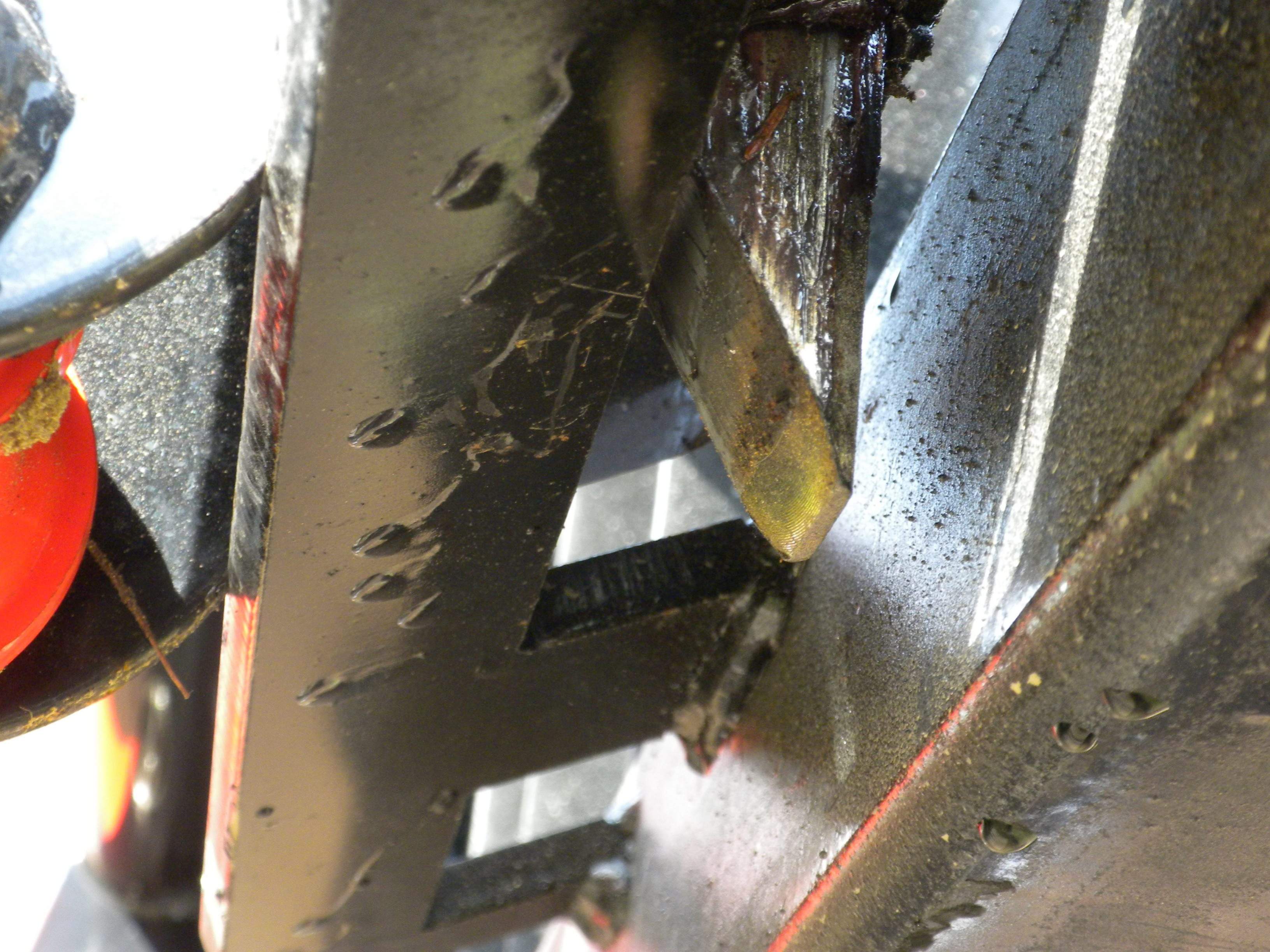

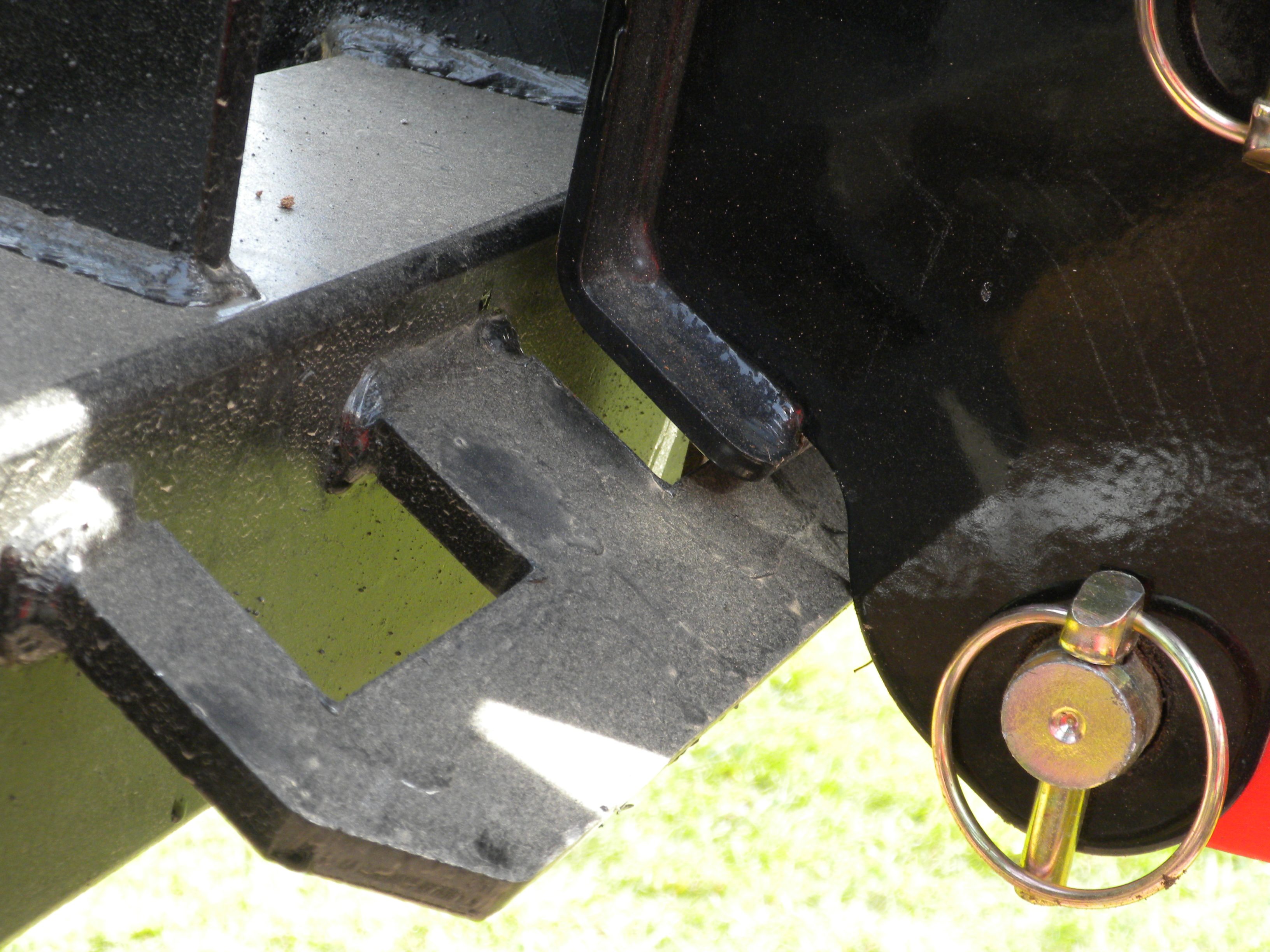

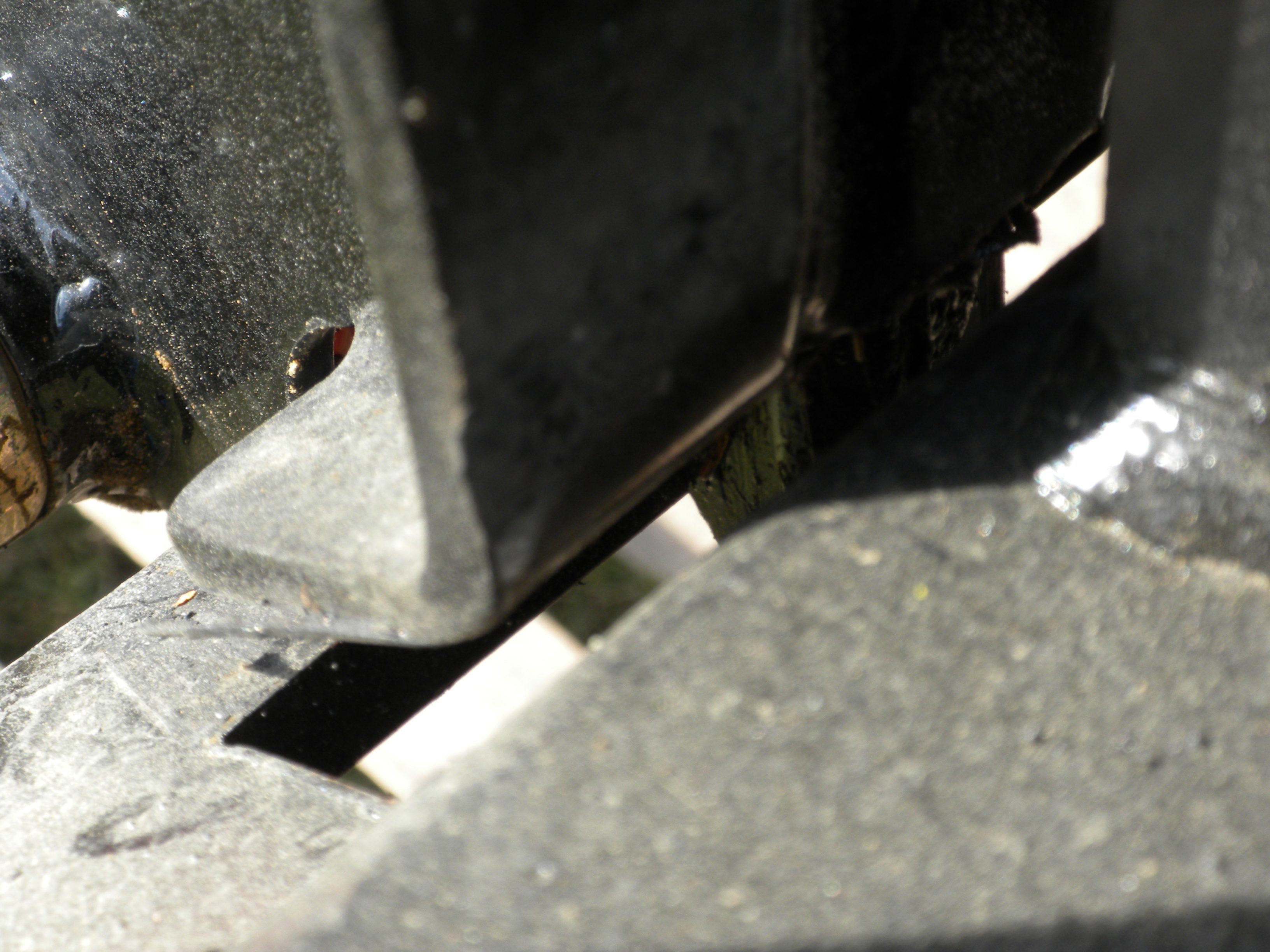

Do I have this on right? There is no gap like this when my bucket is on.
The contour of the loader arm fits perfectly on the bucket, but on this (grapple) there is a gap and the flange doesn't fit into the contour. I guess most of the weight and stress will be on top so maybe this isn't an issue?
It's a bit loose. It should be tighter, and could lead to a problem with it coming off in certain situations. I had to shim my gap, which was similar, but the root of the problem I had with the Gator grapple coming off is a combination of their grapple design with no support behind the SSQA plates and the Kubota SSQA design of the top lip of the bracket. This is mostly a problem on the 48" as there are no grapple tines to provide any support. The 60" version has a tine there, which is appears you have, if indeed that is a Gator.
How did you shim? Should I have shim plates welded on?
