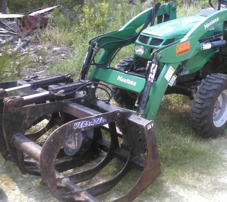

I'm also researching a future grapple purchase, what's everyone's opinions on versetech? I have to agree with with the comments that you shouldn't typically need the ultra heavy duty 3K grapple....
   / Grapple research and tentative conclusion what may be best for me; what do YOU think? #15
I have a Versatech on my 4540 Montana. It was used unmercifully by the PO who used it in a tree removal business after Katrina. Other than the tips of 3-4 tines being bent, it works great. And the way it's made it will hold small items, just not clamped. And his original 2006 invoice says it was $1600.
Not a great pic but you get the idea.
   / Grapple research and tentative conclusion what may be best for me; what do YOU think? #16
I have a Versatech on my 4540 Montana. It was used unmercifully by the PO who used it in a tree removal business after Katrina. Other than the tips of 3-4 tines being bent, it works great. And the way it's made it will hold small items, just not clamped. And his original 2006 invoice says it was $1600. I'll see about adding a pic of it.
Kool....thanks for the QUICK review! :)
Is it a single or double cylinder? 60, 66"??
   / Grapple research and tentative conclusion what may be best for me; what do YOU think? #17
Double cylinder; one on each clamp. I haven't measured but probably a 66" if not bigger.
