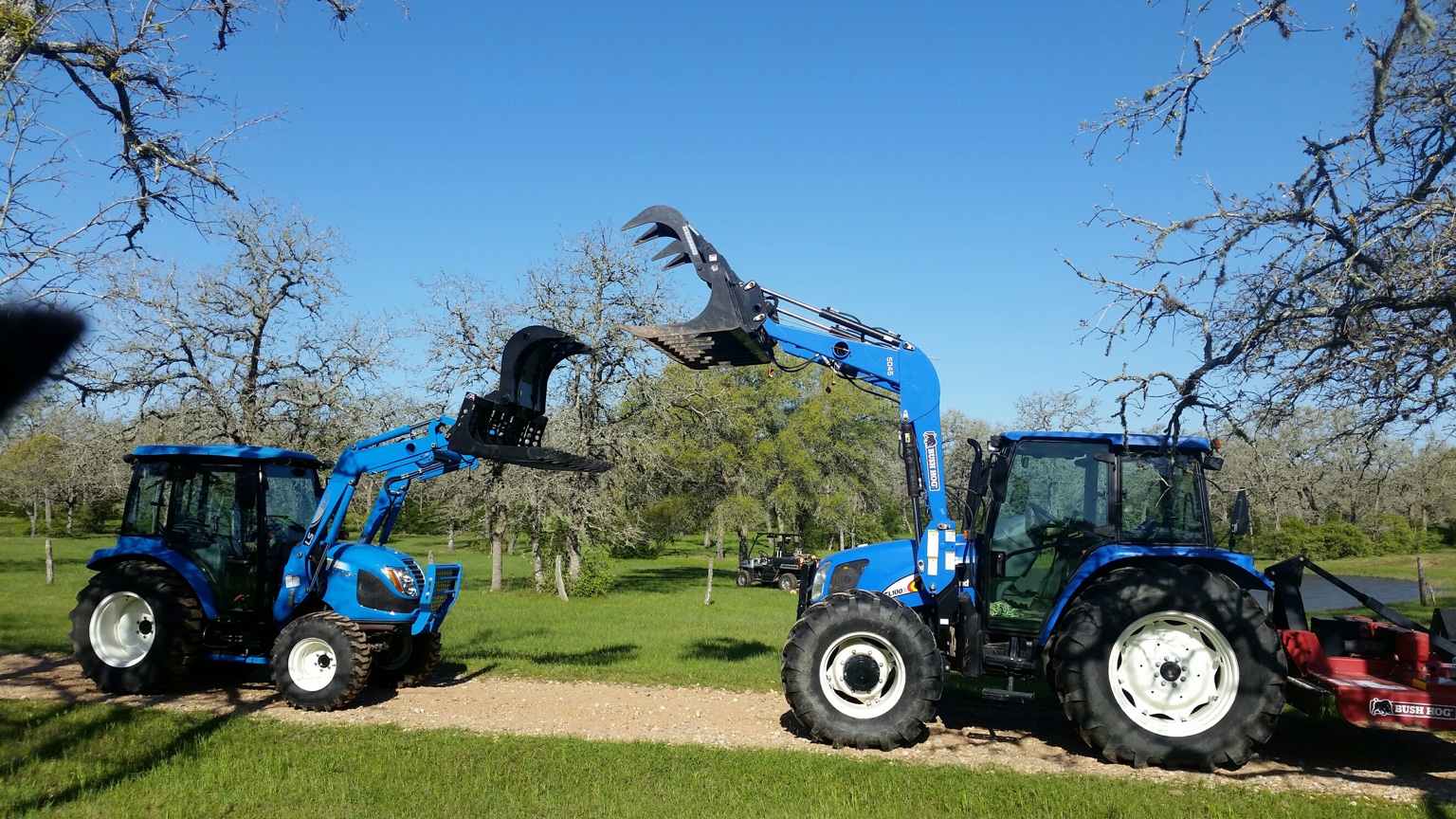

I've installed the WR Long kit on both of our tractors and can highly recommend them. Both have been trouble free.
