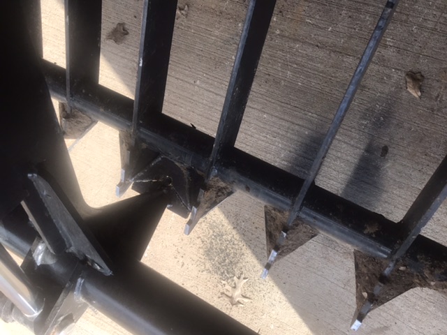

I have the mtl 48 and it has been great.
I will try to post a picture of one solution to improve the bite on small trees that逞エ worked for me.
I guess I can稚 add pictures from my phone, I welded a piece of 3/8 plate between center bottom teeth with v notch to fit top center tooth. Will even grip vines now
Saplings are fun now

The MTL is well built for the money. Their website says the 48" weights 360 lbs.
I would like to see your modifications.
Here is the sticky on photo posting.
https://www.tractorbynet.com/forums/photos/107314-photo-posting-how.html

Thanks for the help with pictures, I’ll get a better one to show the modification
