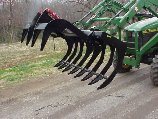

I got one last year on ebay from a dealer in FL but it was shipped from the manufacturer. The price was a little less that the one currently listed on ebay. The grapple is for SKIDSTEER attachment so I built some adapters for my JD 430. Also the pivot joints for the grapple are bolts not bearings of bushings of any kind. Heavy and constant work will ware the bolts and holes in the attachment.
I found the grapple a little heavy for my JD 4300 but still gave the loader the capacity to get the limbs, branches, etc. that I wanted. It really makes a ballast a must.
The hydraulic system worked will since I had a 4 in 1 bucket and bunch of extra hydraulics added. The two grabbers do NOT come down at the same rate so you may twist something as you grab it. The root grapple part is pretty difficult to preform since the long loader lets the teeth drop up and down in the ground as you try to dig out roots, especially on anything but flat ground.
In addition to the attachment check the Grapple Pictures link. While there check the other albums on the left for the various hydraulics, etc.
I have no problem with the grapple but don't expect it to pick up really heavy stuff it the tractor and loader won't handle it . It is lighter than most but still heavy. Construction is of adequately strong material and operation is fine.
Hope this helps.

Thanks a lot. That's what I needed to know. I'm not looking for commercial grade, so the wear points aren't a problem. The pictures really helped.

Charlie, If you end up with Versa-Tech or like Jim (liledoun) showed you may not need to tilt the PT plate. My comments applied to the AnBo type and Long, but this style already lets you get under a load as it is. Some tilt still should not hurt anything though.
