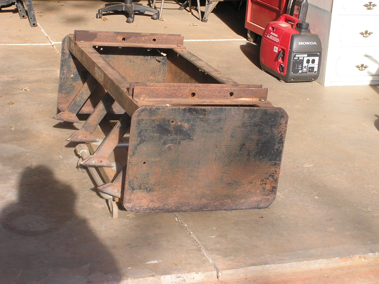

If you can store it on a dolly, it will be much easier to pin on.
Here is my 4' pin on box blade on a dolly:
