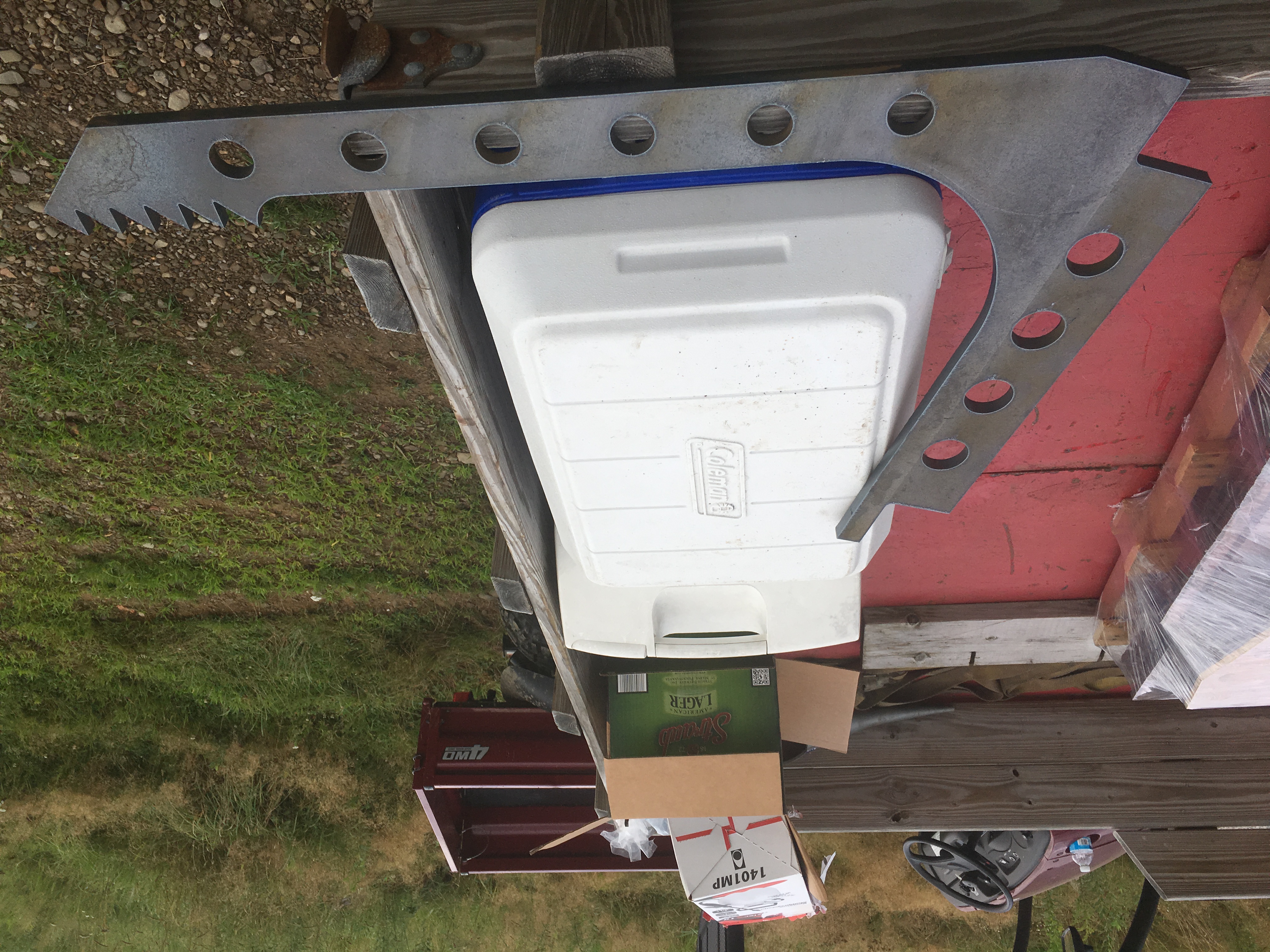

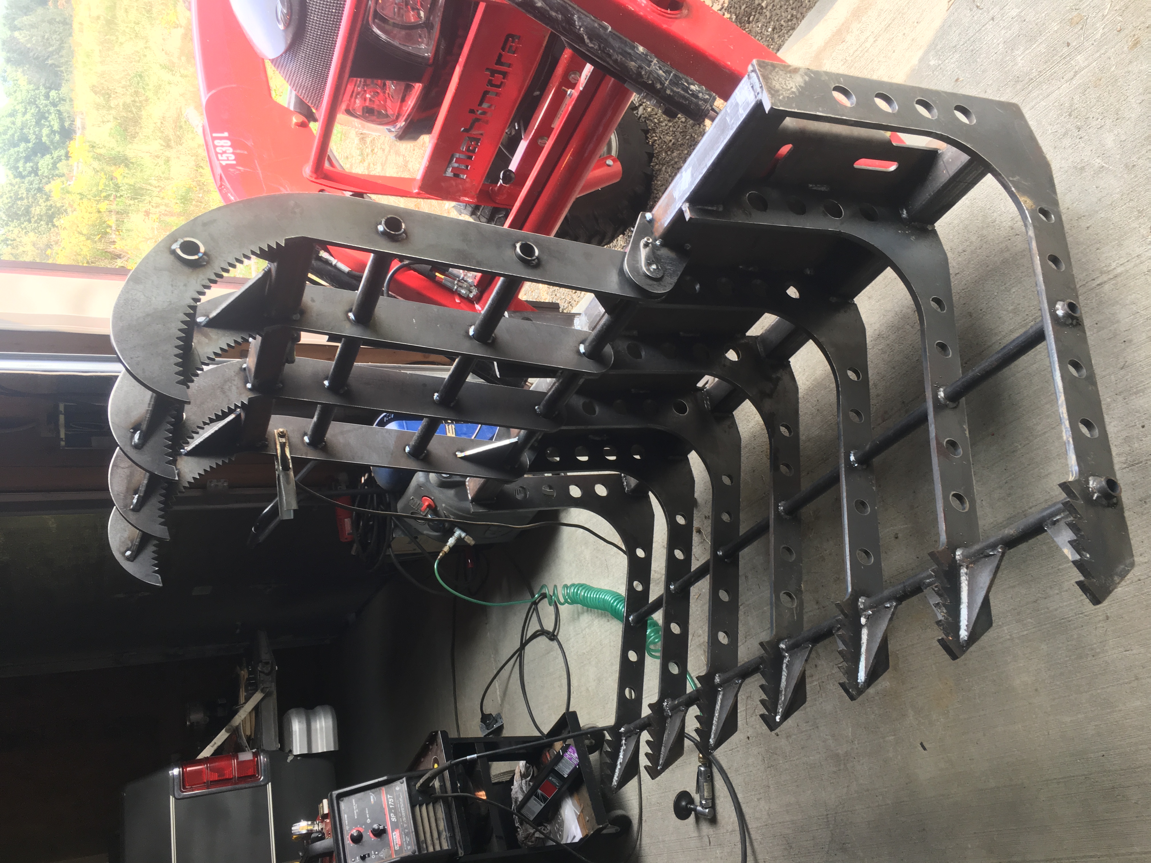

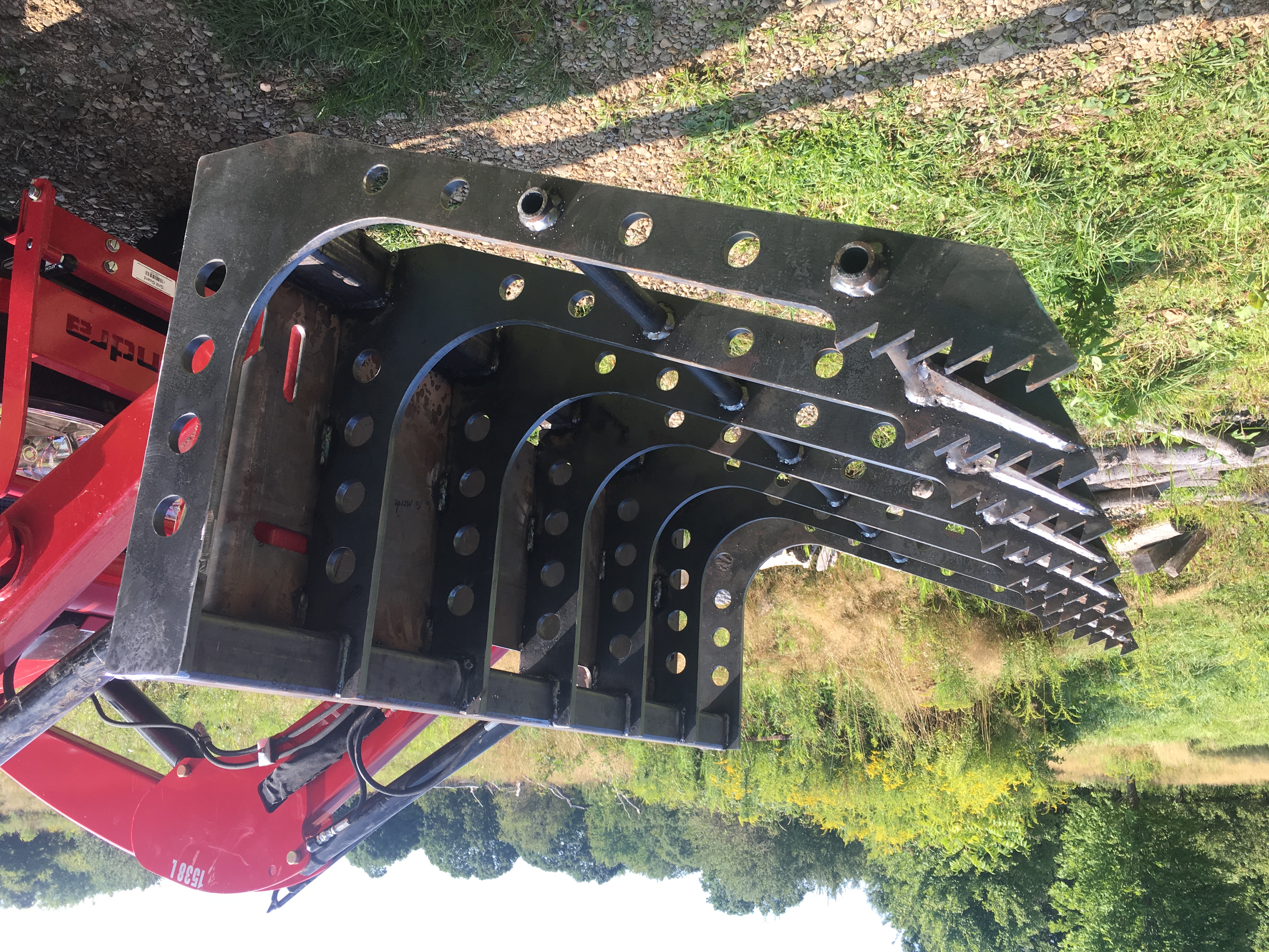

New member here. Thought you all might be interested in seeing some pics of a grapple project I've been working on for a month or so. Bought a new Mahindra 1538 Shuttle in July to replace my tired Ford 3000. So it seemed like I needed something else to put on the loader and a grapple looked like something I could really use.

Andy that looks awesome! How did you cut all of your teeth? Looks like a fun and nicely done project. And watch the Ford 3000 cracks! I just bought a '65 gasser with a loader, nice tight machine. :)
   / Grapple project

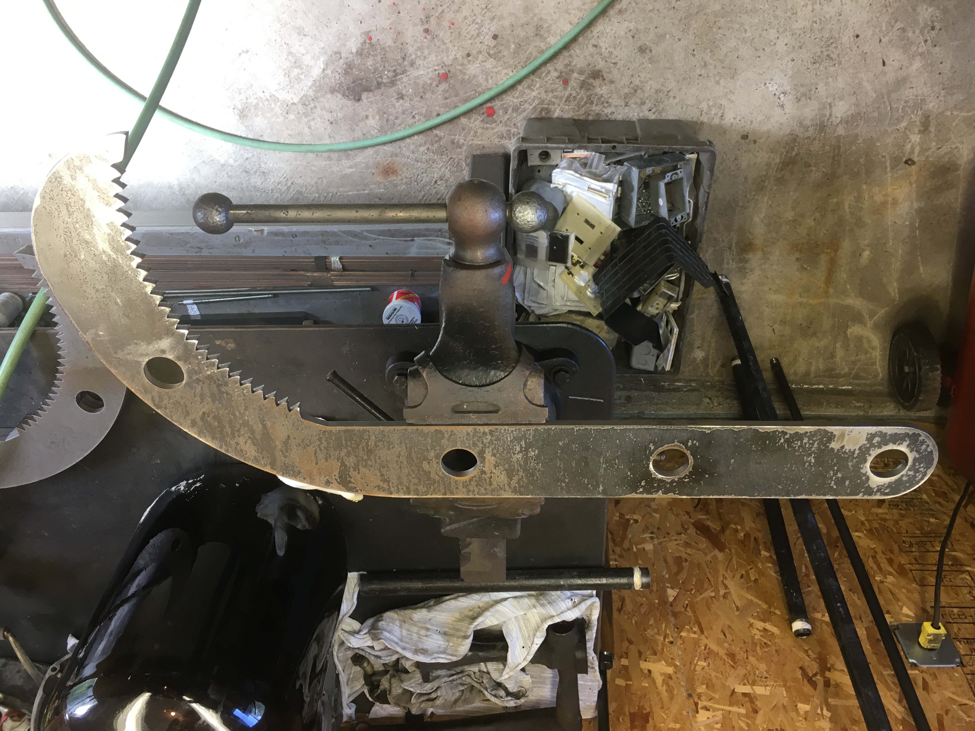

Have a friend who has a CNC plasma machine. So I designed the pieces that needed burned out and sent him the CAD files. No disrespect meant on the Ford. Mine was still reliable as a stone but was high hours and needing some love that I didn't have time for. Plus I wanted FEL and 4x4 so sent the 3000 and a 63 Case 310 diesel dozer to a new home and upgraded.
   / Grapple project #5
Very nice, pretty stout looking as well. I find the round bottom of mine to be indespensible for back dragging and smoothing dirt out. Your gonna love having the ability to pick stuff up, whole new world.
   / Grapple project

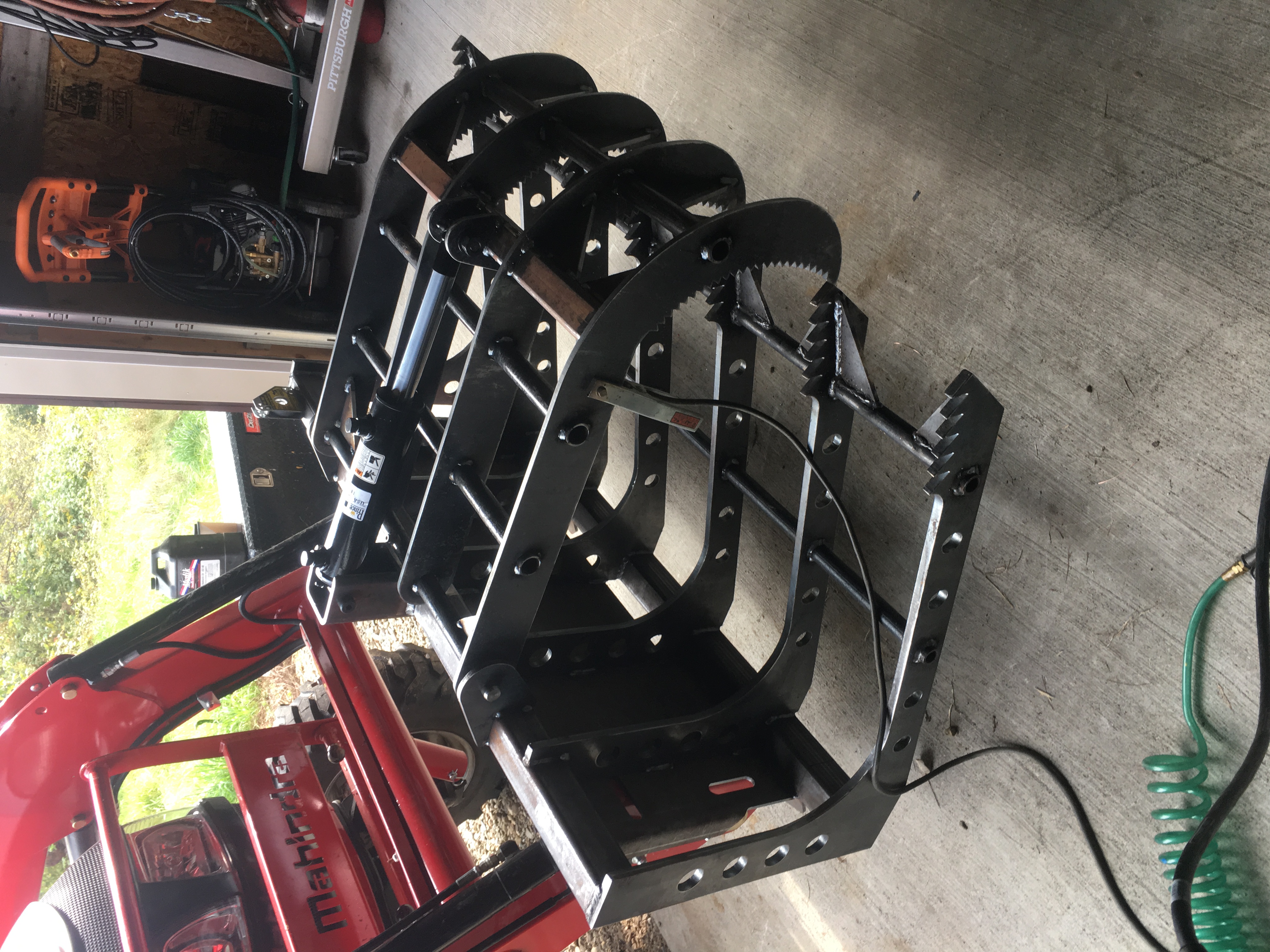

Yes looking forward to getting it done. The top part is just tacked together. Hopefully will have time this weekend to take the top section off and fully weld it. Then I just have to put the hoses and quick connects on. Had place logged last winter so I think this will save my back with tops and brush cleanup.

Nice job Andy. Great design and welds. I love my grapple but I wish I had the talent to have designed and made it.

Yes anxious to get it done and try it out. Has been a good project. Tried to take what I felt were good features from several of the factory made ones. It will be fun learning how to use it. I think it's going to be handy for holding logs at a good working height to buck it up.
