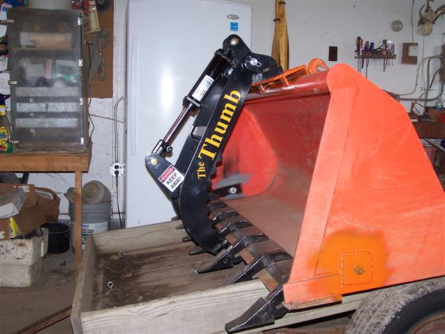

Well, after about a month of busy schedules and delays, I finally got my grapple mounted and running. I ordered "the Thumb" to mount on my home made bucket, due to the combination of size, weight, and price. The bucket has odd dimensions that needed a little extra fabrication to make everything fit, but I'm happy with the end results.
My dad and brother were very instrumental in the whole project, which I have been documenting with the camera. Here are a few pics:

Thanks to everyone on TBN for all the posts that have contributed to my decision to pursue this project. Yes, this grapple does have a huge reach to it, and it really grabs a big mouthful of material. It's the 32" thumb made by Greens Machine Shop (They make several sizes!). We also ground some serrations, or teeth into the sides of the blade to help with the grip when grabbing long material. Probably not necessary, but doesn't hurt anything either. Our local Cenex guy invited my dad and me to help with the hydraulics, and when it was time for the bill, he only charged me for the parts, claiming we did all the work! :thumbsup:

This is a quick detach at the pivot. The biggest reason I didn't make it the whole length of the bucket was for weight savings. The grapple added enough weight by itself, and these smaller tractor/FEL combos need all the help they can get. :D In all I probably added about 1oo lbs to the bucket, but about 70 lbs comes off when I remove the jaw. Only the base remains on the bucket.

I added a Green's Machine thumb and a tooth-bar from Markum Welding,works great.

nybirdman, your Kubota is significantly larger than my Ford. Makes the grapple look positively small! I see you also added a mounting plate to your bucket. Looks great! The tooth bar looks like a great addition also.
