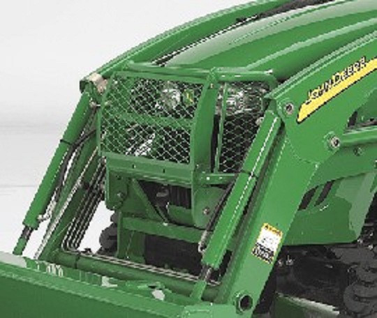

That's something that very much concerns me. I can't believe Kubota doesn't make/sell a grill guard that adresses this problem. Jd make a great guard for around $260 that bolts right on. Wonder if it would fit on a Kubota :ashamed:

You have the standard grill guard, just need to modify yours a little, for that price you could add expanded metal and a couple of wings.
I'd be concerned about the hood as well.

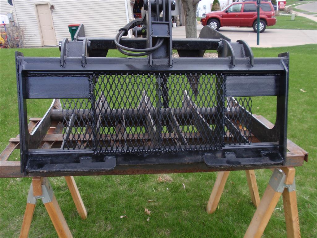

I thought about making a grill guard, but decided to move the guard onto the grapple itself. It helps brush pickup and addresses the problem right at the source. I added 3/4" #9 expanded metal to the open center area, so it holds in basically everything but I can still see through it easily. I also added the angle brackets to help it stay put on the SSQA arms (an issue with the Gator design on a Kubota QA). The areas of the back not covered at the outside edges are covered by the QA plates when on the loader.

That looks like a step in the right direction. Well done! :thumbsup:

I never checked with Kubota. They may make one. On the other hand, it was a good first project for my new welder! The Deere guard that you show still would concern me. It gives no protection down low, and that's where my tractor got impaled from. I'll have to post some pixs of mine, but I may be embarrased. It was my first welding project and it is not exactly a work of art, but it does serve its purpose. I made an angle iron frame and used bar grating for the screen, so its pretty bombproof, just not pretty!
The expanded metal on the grapple is also a great idea. In reality, having both types of guards would be good. I sometimes injure my tractor when I drive over saplings, especially ones that break off and lean towards me. They seem to find the opennings. So it's not just the stuff I am grabbing with the grapple, as it's also the nature of plunging into thickets blindly. And believe me, if you have a grapple, nothing is more fun than lowering it and knocking stuff down!
