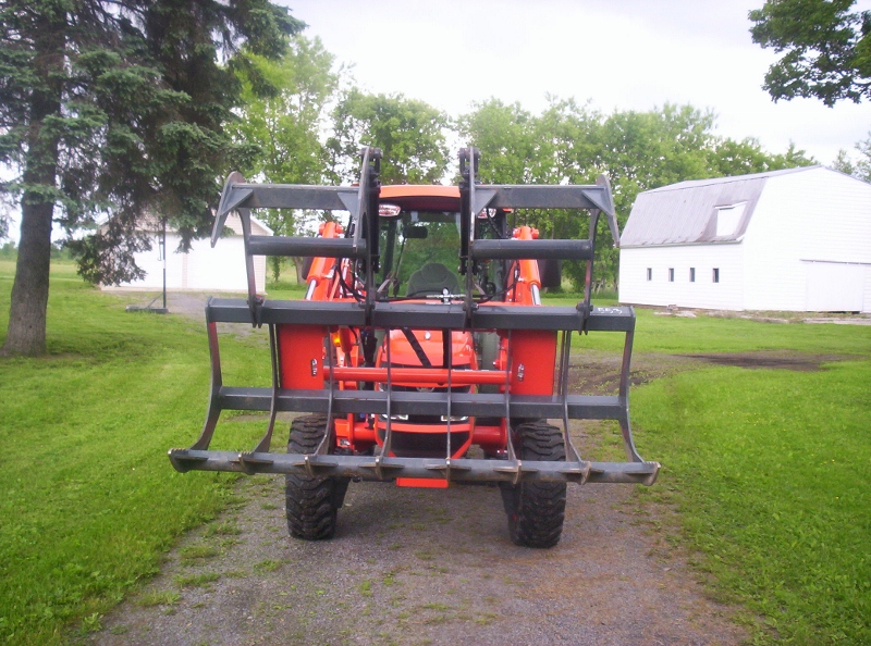

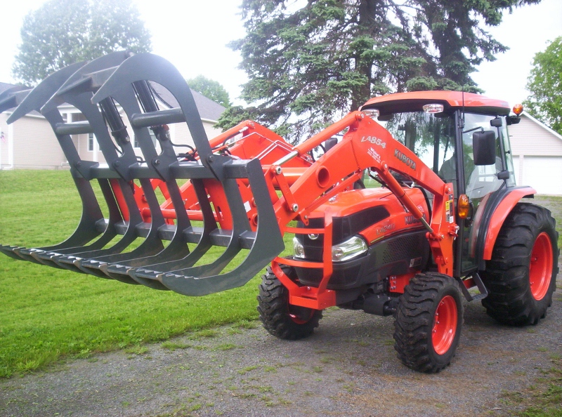

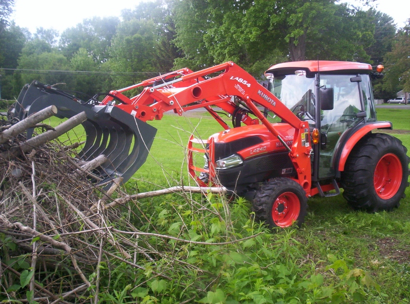

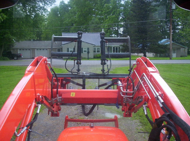

Finally got the Root Grapple hooked up so between rain storms I snapped a few photos :D
Used it a little yesterday but everything is so wet things became counter-productive real quick.

Very nice, who manufactured it? I looks very similar to the Millonzi unit's that that ceased to exsist due to the company folding after the owners demise.
Matt
   / Grapple Photos #4
That looks just plain mean! You will no doubt find no end of jobs to do with it, and after awhile, you'll wonder how you ever lived without it.

Matt,
It's a Fabtech/Versatech brand which I picked up semi-locally (90 miles round trip). Kind of a lucky find and at the last minute too. I was all set to buy the Construction Attachments brand from Everything Attachments when I stumbled across this one.
Can't say I'm all that familiar with the Millonzi's but I have heard the name. :)
   / Grapple Photos #6
Good luck with it! :thumbsup:
   / Grapple Photos #7
Matt,
Millonzi, was kind of the first company to market grapple's for the CUT market. There's a fellow on here named Island tractor, he's kind of the godfather of grapples on TBN. You'll quickly find how many uses the grapple has. I was torn between this style and the ATI clamshell type but for my needs this style is the best fit. Now have fun playing with your new toy!
Matt
   / Grapple Photos #8
Very nice set up. I'm about to take delivery on a new Grand L 4240, also with a root grapple. However, the dealer ordered one from ceattachments.com and it appears to be for a skid steer. http://www.ceattachments.com/Libraries/Skid_Steer_Spec_Sheets/Brush_Root_Grapples.pdf
I'm a little concerned about the extra weight on the 854 FEL. Looks like this one is 820 lbs, at 72". I'm thinking that while the 854 shouldn't have trouble handling it, I wonder if it's overkill. I'm clearing brush and some fairly large ash trees. I've seen the offerings from everythingattachments.com and also looked at the versatech you purchased. Mine comes in at around $2500. Any thoughts? Thanks for your input.
