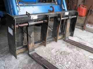

I can't seem to find this in Search, maybe someone can direct me.
I've got a sturdy set of forks I use for moving logs and brush. Brush seems to easily slide off when I'm going over bumps so I've been thinking to add a set of arms to hydraulically clamp down on the load. I think I can build a pair, with a cylinder to run each, teed together and run from the remote valve with long hoses, as I run the power angle on my snow plow.
What I wonder is, has anyone used a combination like this? Logs are no sweat, but for picking up and holding onto brush? I have no need of a root grapple, I just want to hold stuff from sliding off the forks. Fork tines are 4' long, tractor is 6000 lbs., loaded rears.
Also, these forks are mounted on a piece of bar stock maybe 1½" dia. They swing free when the "bucket" is dumped, so you can slide each fork sideways adjust the width. When dumping brush onto a burn pile, that free-swing is a pain as forks get stuck in the tangle. Anyone come up with an idea for holding them to the frame without doing so permanently, ie so you could adjust them if necessary?
The pic shows the forks and frame, with arrows where I think I'd pivot the clamping grapple arms, and a little box crudely drawn on top of the frame where I'd pivot the cylinders.
This is in the early planning stage where I could use some advice. Thanks in advance, Jim

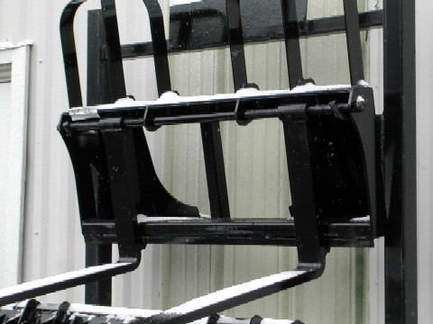

Here is a set of forks sold by Horst Welding with a grapple. I saw a set at a steam show last year and they looked really nice. I just bought an old set of forks, off a forklift, similar to yours and plan to do about the same as you are. To keep the forks from swinging out, the forks I have looked at have a piece of flat stock standing up near the bottom of the framework, with an L welded onto the back of the fork that will slide over the flat stock to adjust the width. I hope this makes sense. The flat stock on yours could go above or below the box tube at the bottom of your framework. I think I would prefer to have it on the bottom for strength when using the forks to push down on something. I will post a picture if I can find one.

Not a great picture, but I think you can see it OK on the bottom.

A suggestion ie. On each end of the frame, weld a piece of steel
approx. 6" square with a 1" overlap on the frame ends. Then attach a piece of 1/2" cold rolled steel bar between these ends as they extend about 1/2 inch in front of the fork up rights. The forks now adjust to width and will not "Roll Out" when you try to tilt forward to "Dump" brush.

Thanks to everyone for responses. I like the idea of the rod holding the forks from dumping, and can add that easily. Also I like the looks of tractors4u's grapple arms - they open wide and clamp tight, just the thing for brush. The arms will help stop anything from sliding down the loader arms, too. Will I need to restrict the fluid to make the grapple cylinder(s) close slower? I imagine the geometry matters in the distance between arm pivot pins and cylinder pins plus the arc of the arm travel. Anyone have an opinion on one pair vs. two separate arms with separate cylinders? More complexity, more capability, the usual tradeoff? I'll post pix when I get to building.
