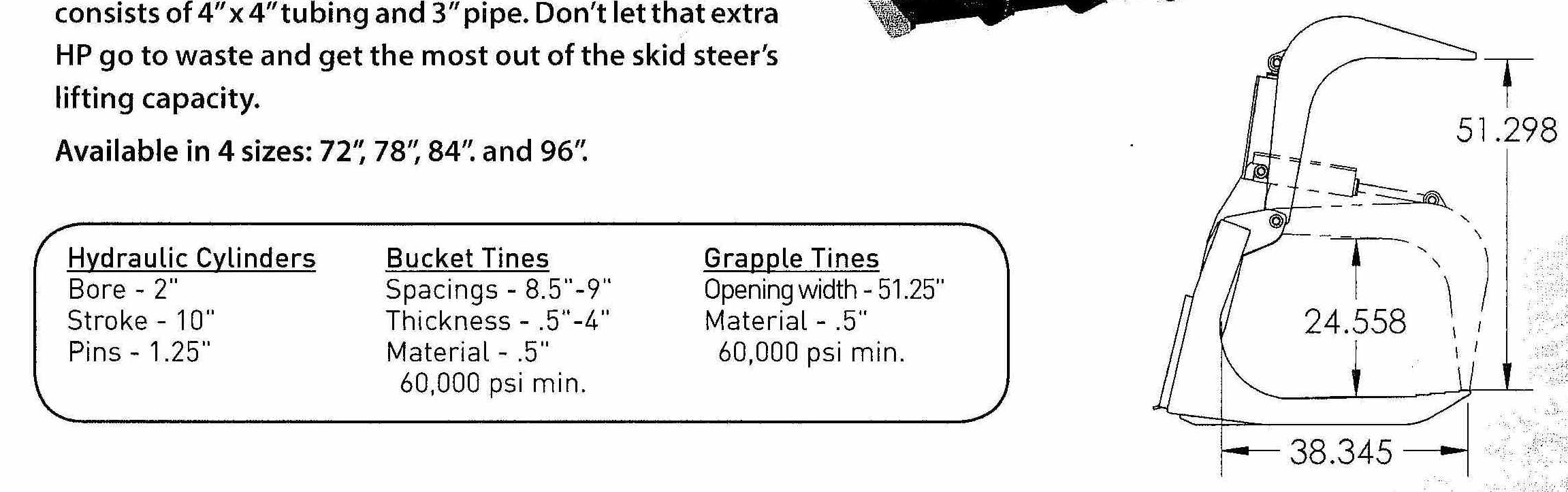

I am currently in the middle of getting more training on autocad/revit. I have to design something as an assignment and make it via 3d printer or using a Cnc laser table. I thought what would be a better project then a grapple for my L3800.
I'm looking for measurements, dimensions on grapples guys have used or made so I can create my own. I have a basic design drawn out but always like to compare.

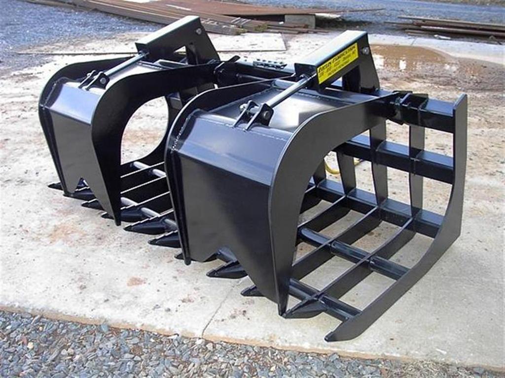

Does your tractor have the quick attach as in skid steer type? If so, I do have some dimensions for that. I also have an EA 48" double lid grapple I could grab some measurements off if you need it.

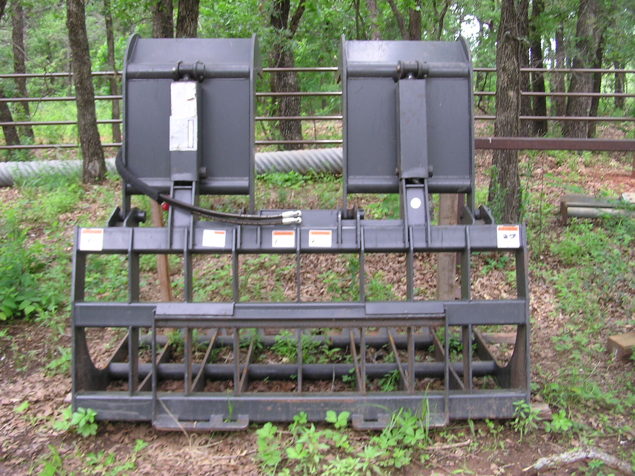

Here is my 72" wide Monster Grapple:
