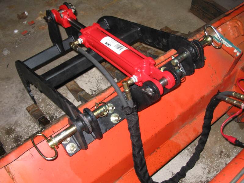

OK, now that I am home I just measured the top support block for my Tatro grapple and I was a little off.:( The top plate is actually 1" x 3" x 24" which according to my handy weight chart, weighs in at a little over 20 lbs. Adding in the mounting tabs, the cylinder (20 lbs) and the grapple arms (about 20 lbs), I would guess the total weight is in the 60-65 lb range.

Yes, that's what I was afraid of. The sheet metal on the top of our Kioti bucket is thin and seeme to form a void on the top. Those bolts could smash it up just by tightening them and even more when you squeeze something.
If a guy used square tube across the top, how would you tighten the nuts on the bolts? Or would you weld in spuds?
