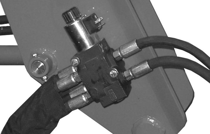

Okay, here's the details of the Solenoid Valve Kit. Mind you, I'm not very good at taking pictures, but I think you'll get the idea of what MF has in place for this solution.

All that for $200? I just don't believe it.
How many hoses connect to the solenoid valve-4 or 6? I can't see in the pictures.

Sure enough, I told you I was bad at taking pics. ;)
It looks like 6 hoses from this shot.
OK, so it is a "diverter". I just wanted clarification...
Now, back to the price?

One dealer "said" $200. However, the dealer I've recently been working with quoted me $683. He seemed to be more on the ball and better understood what I was trying to accomplish with this. He was also able to get the tech specs from MF on the solenoid valve.
