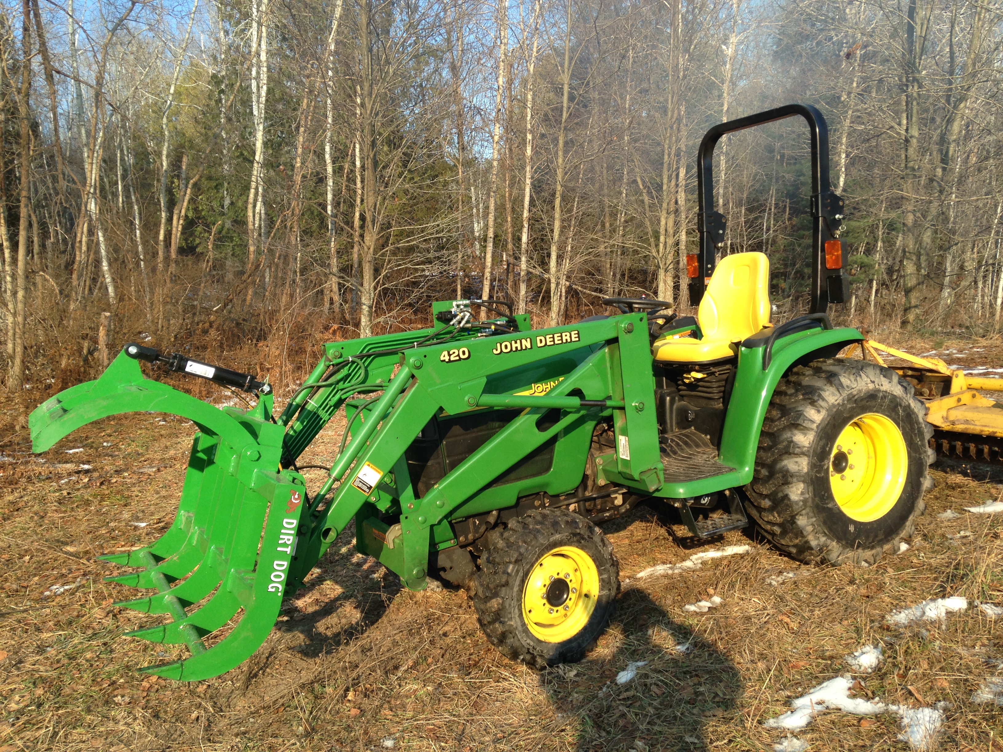

I have the Dirt Dog 60" grapple for my 4310. Due to the lack of a flat lower section it's kind of hard to scoop up debris so usually I push it all into a pile before I start grappling it up. I do like how it's fairly light and how much the lid can come into the frame to pick up object. I've actually gotten pretty good at setting boulders the think and use it quite often to buck logs into firewood. Originally got it with the idea to rip out autumn olive shrubs with it but the bucket with the piranha toothbar does a much better job. I just use it now to haul the shrubs to the burn pile now.

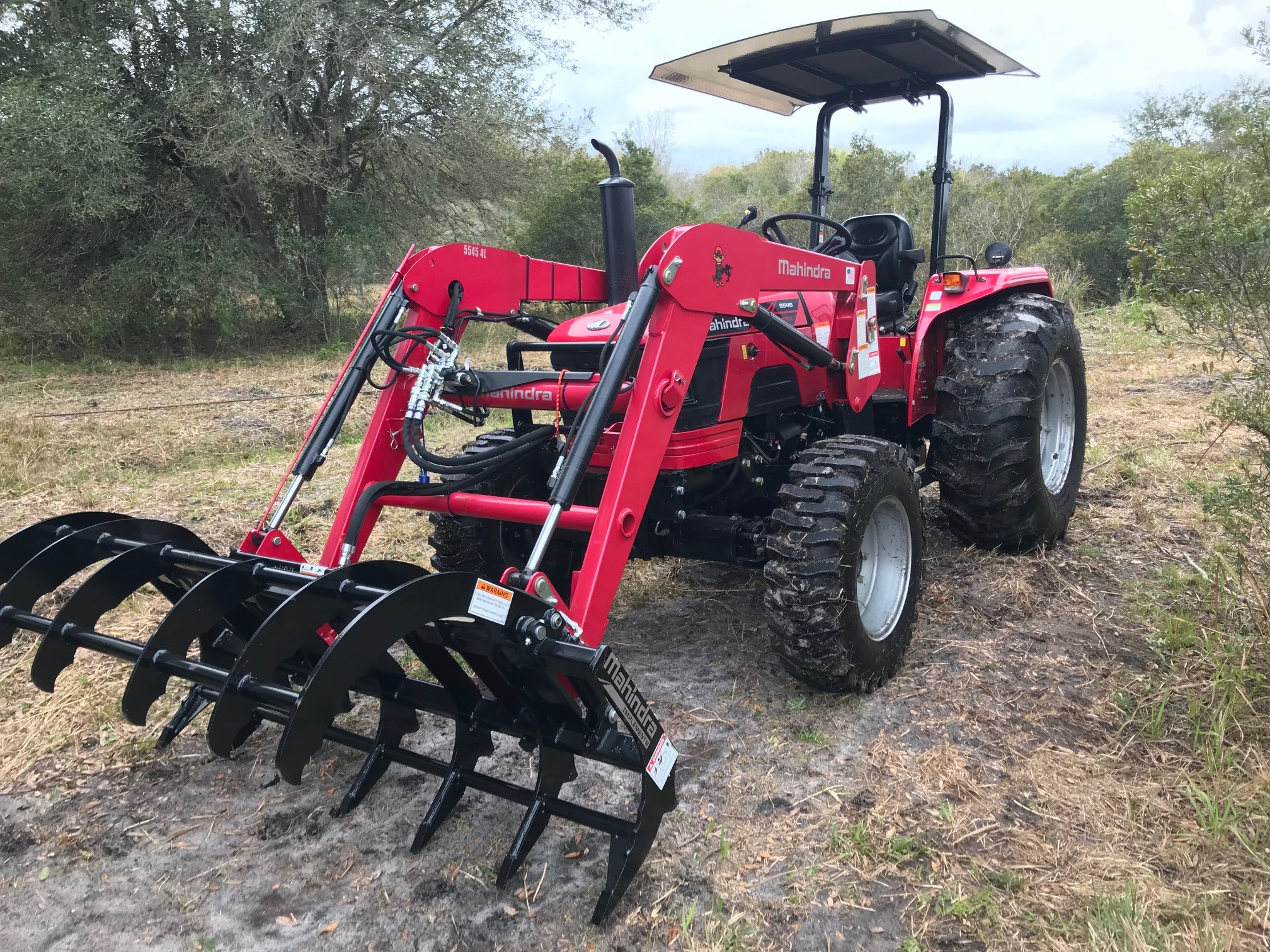

Thanks so much for all your feedback. I ended up buying the Mahindra grapple from the dealer. Used the dickens out of it this past weekend. Worked like a champ. I will have to weld a short piece between the upper tines so it will close tight to pull fence posts. It isn't as heavy duty as some of the others, but we have very sandy soil here in Florida, so I think I'll be fine.
