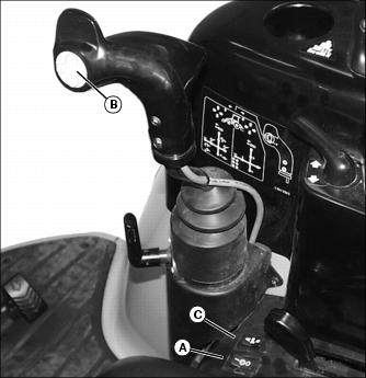

Ok this is the 110 stick (from Deere.com)
Standard hydraulic dual selective control valve (SCV) operation is unchanged.
A - Third SCV On/Off Switch - Turns third SCV on or off.
B - Third SCV Momentary Switch - Sends hydraulic fluid to the third SCV quick couplers while switch is depressed.
C - Third SCV Continuous Switch - Sends hydraulic fluid to the third SCV quick couplers as long as switch is in A or B position

My 5525 has the same style joystick as the 110 - it is very handy. I am still wondering what that 3rd button on there is for... I use the open and close, but what is the other one? Or is it a button?
D.
   / grapple bucket installation #9
The forward button on the 110 is for momentary pause/activation of the selected circuit. The circuit can be preselected to run constant flow in either direction & this button will activate/deactivate it
